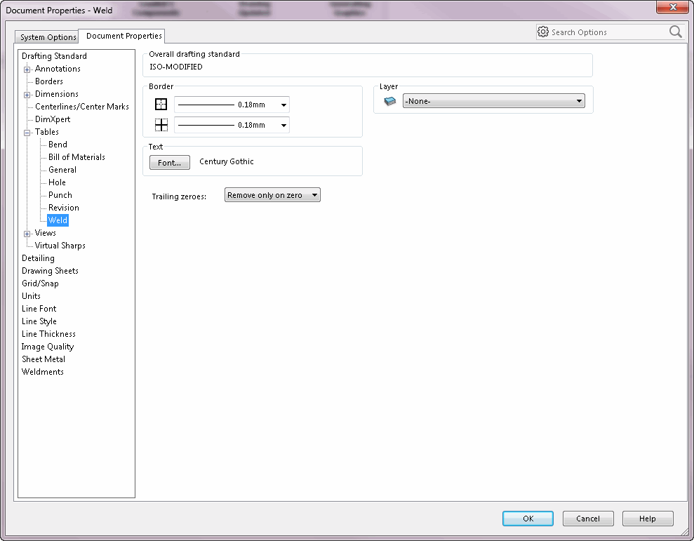

Document Properties > Tables > Weld
NOTE: Setting any of the following weld
table values means that new weld tables added to the drawing use these default
values. However, a weld table that uses a template table for insertion might
not use these default values because the template table contains certain
properties that take precedence over these default values.
Setting |
Get/Set Methods |
Return Value or <Value> |
Comments |
Border - Box Border |
IModelDocExtension::GetUserPreferenceInteger(swUserPreferenceIntegerValue_e.swDetailingWeldTableBorderLineWeight,
swUserPreferenceOption_e.swDetailingNoOptionSpecified)
IModelDocExtension::SetUserPreferenceInteger(swUserPreferenceIntegerValue_e.swDetailingWeldTableBorderLineWeight,
swUserPreferenceOption_e.swDetailingNoOptionSpecified, swLineWeights_e.<Value>) |
See
swLineWeights_e for valid options |
Border - Grid Border |
ModelDocExtension::GetUserPreferenceInteger(swUserPreferenceIntegerValue_e.swDetailingWeldTableGridLineWeight,
IModelDocExtension::SetUserPreferenceInteger(swUserPreferenceIntegerValue_e.swDetailingWeldTableGridLineWeight,
See swLineWeights_e
for valid options |
Text - Font... |
IModelDocExtension::GetUserPreferenceTextFormat(swUserPreferenceTextFormat_e.swDetailingWeldSymbolTextFormat,
IModelDocExtension::SetUserPreferenceTextFormat(swUserPreferenceTextFormat_e.swDetailingWeldSymbolTextFormat,
swUserPreferenceOption_e.swDetailingNoOptionSpecified, <Value>) |
See ITextFormat
for font options |
To set font property values, implement ITextFormat, set the appropriate
ITextFormat member values, and pass the ITextFormat object in the
set method |
Trailing zeroes |
IModelDocExtension::GetUserPreferenceInteger(swUserPreferenceIntegerValue_e.swDetailingDimTrailingZero,
swUserPreferenceOption_e.swDetailingWeldTable)
IModelDocExtension::SetUserPreferenceInteger(swUserPreferenceIntegerValue_e.swDetailingDimTrailingZero,
swUserPreferenceOption_e.swDetailingWeldTable, swDetailingDimTrailingZero_e.<Value>) |
Valid options in swDetailingDimTrailingZero_e:
- swDimShowTrailingZeroes
- swDimRemoveTrailingZeroes
- swDimRemoveOnlyOnZero
- swDimSameAsSource
Layer |
IModelDocExtension::GetUserPreferenceString(swUserPreferenceStringValue_e.swDetailingLayer,
IModelDocExtension::SetUserPreferenceString(swUserPreferenceStringValue_e.swDetailingLayer,
swUserPreferenceOption_e.swDetailingWeldTable, <Value>) |
Valid options:
- "Border"
- "Dimensions"
- "Notes"
- "BOM"
- "FORMAT"
"None"
This setting is available only on drawings; depending on drawing, some
options may not apply |
