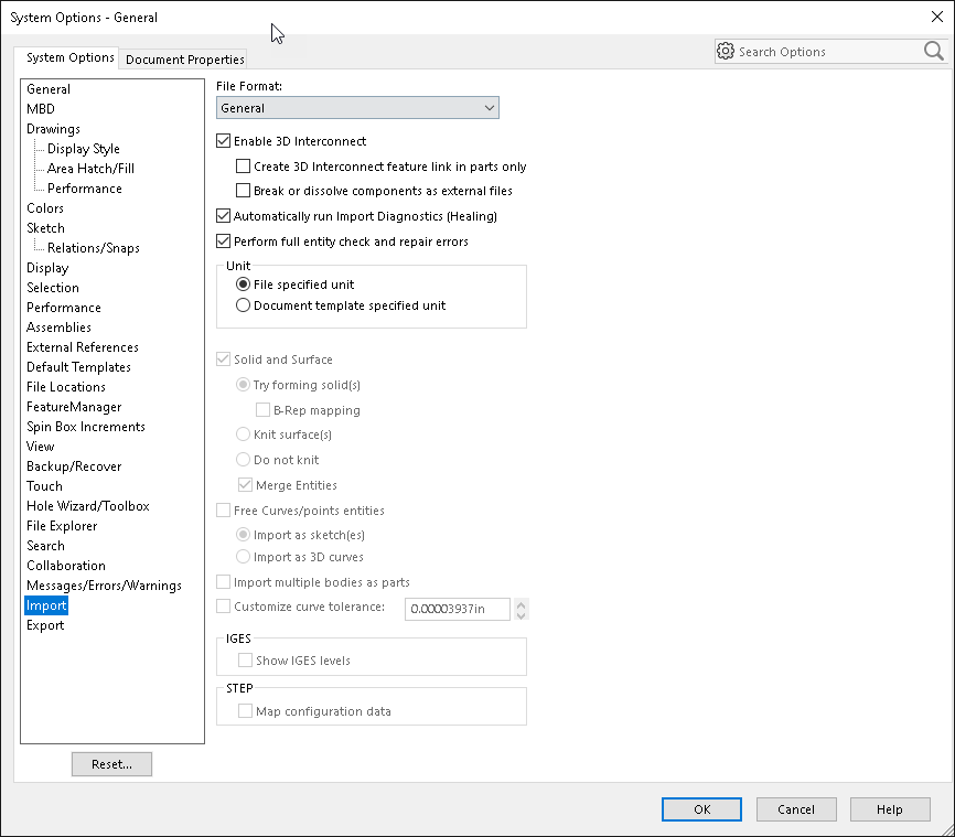

System Options > Import > General
This topic contains two tables. The information in the table:
  • appearing immediately after the dialog corresponds to the settings on that dialog.
  • titled Obsolete Enumerators contains enumerators that previously appeared on the dialog but are now obsolete.
To display the dialog:
Select Tools > Options > System Options > Import > File Format > General.
- or -
  1. Select File > Open.
  2. In Files of type, select:
  • Parasolid
  • IGES
  • STEP AP203/214/242
  • IFC 2x3
  • ACIS
  • VDAFS
  • Unigraphics/NX
  • Inventor Part
  • Inventor Assembly
  1. Click Options.
Setting
Get/Set Methods
Return Value
or
<Value>
or
<OnFlag>
Comment
Enable 3D Interconnect
ISldWorks::GetUserPreferenceToggle(swUserPreferenceToggle_e.swMultiCAD_Enable3DInterconnect)
ISldWorks::SetUserPreferenceToggle(swUserPreferenceToggle_e.swMultiCAD_Enable3DInterconnect, <OnFlag>)
Boolean value
Create 3D Interconnect feature link in parts only
ISldWorks::GetUserPreferenceToggle(swUserPreferenceToggle_e.swMultiCAD_ApplyOnlyToParts)
ISldWorks::SetUserPreferenceToggle(swUserPreferenceToggle_e.swMultiCAD_ApplyOnlyToParts, <OnFlag>)
Boolean value
Valid only if swUserPreferenceToggle_e.swMultiCAD_Enable3DInterconnect is true.
Break or dissolve components as external files
ISldWorks::GetUserPreferenceToggle(swUserPreferenceToggle_e.swMultiCAD_CreateNewComponentsAsExternalFiles)
ISldWorks::SetUserPreferenceToggle(swUserPreferenceToggle_e.swMultiCAD_CreateNewComponentsAsExternalFiles, <OnFlag>)
Boolean value
Automatically run Import Diagnostics (Healing)
ISldWorks::GetUserPreferenceToggle(swUserPreferenceToggle_e.swImportAutoRunImportDiagnostics)
ISldWorks::SetUserPreferenceToggle(swUserPreferenceToggle_e.swImportAutoRunImportDiagnostics, <OnFlag>)
and
ISldWorks::GetUserPreferenceToggle(swUserPreferenceToggle_e.swImportAutoRunImportDiagnosticsPersist)
ISldWorks::SetUserPreferenceToggle(swUserPreferenceToggle_e.swImportAutoRunImportDiagnosticsPersist, <OnFlag>)
Boolean value
and
Boolean value
Specifies whether import diagnostics (healing) are run automatically. If TRUE, they are; if FALSE, they are not
and
Specifies whether users are presented with a dialog asking them if the import diagnostics (healing) should run; if True, then users are not asked and automatic healing is done depending on the value of swUserPreferenceToggle_e.swImportAutoRunImportDiagnostics; if False, then users are asked
Perform full entity check and repair errors
ISldWorks::GetUserPreferenceIntegerValue(swUserPreferenceIntegerValue_e.swImportCheckAndRepair)
ISldWorks::SetUserPreferenceIntegerValue(swUserPreferenceIntegerValue_e.swImportCheckAndRepair, <Value>)
  • 0 = Do not check and repair
  • 1 = Check and repair
Unit - File specified unit
ISldWorks::GetUserPreferenceIntegerValue(swUserPreferenceIntegerValue_e.swImportUnitPreference)
ISldWorks::SetUserPreferenceIntegerValue(swUserPreferenceIntegerValue_e.swImportUnitPreference, swGeneralImportUnitsOptions_e.swGeneralImportFileSpecifiedUnit)
See swGeneralImportUnitsOptions_e for all valid options
Unit - Document template specified unit
ISldWorks::SetUserPreferenceIntegerValue(swUserPreferenceIntegerValue_e.swImportUnitPreference, swGeneralImportUnitsOptions_e.swGeneralImportDocumentTemplateSpecifiedUnit)
Solid and Surface
ISldWorks::GetUserPreferenceToggle(swUserPreferenceToggle_e.swImportSolidSurface)
ISldWorks::SetUserPreferenceToggle(swUserPreferenceToggle_e.swImportSolidSurface, <OnFlag>)
Boolean value
Specifies whether to import surface and solid entities; you must also set ISldWorks::SetUserPreferenceIntegerValue(swUserPreferenceIntegerValue_e.swCreateBodyFromSurfacesOption, swGeneralImportSurfaceSolidEntityOptions_e.<Value>)
Try forming solid(s)
ISldWorks::GetUserPreferenceIntegerValue(swUserPreferenceIntegerValue_e.swCreateBodyFromSurfacesOption)
ISldWorks::SetUserPreferenceIntegerValue(swUserPreferenceIntegerValue_e.swCreateBodyFromSurfacesOption, swGeneralImportSurfaceSolidEntityOptions_e.swGeneralImportTryFormingSolids)
See swGeneralImportSurfaceSolidEntityOptions_e for all valid options
B-Rep mapping
ISldWorks::GetUserPreferenceIntegerValue(swUserPreferenceIntegerValue_e.swImportUseBrep)
ISldWorks::SetUserPreferenceIntegerValue(swUserPreferenceIntegerValue_e.swCreateBodyFromSurfacesOption, swGeneralImportSurfaceSolidEntityOptions_e.swImportUseBrep)
and
ISldWorks::SetUserPreferenceIntegerValue(swUserPreferenceIntegerValue_e.swCreateBodyFromSurfacesOption, swGeneralImportSurfaceSolidEntityOptions_e.swGeneralImportByBrep)
  • 0 = Import the model by directly mapping topologies using BREP data
  • 1 = Do not import the model by directly mapping topologies using BREP data
NOTE: You must set ISldWorks::SetUserPreferenceIntegerValue(swUserPreferenceIntegerValue_e.swCreateBodyFromSurfacesOption, swGeneralImportSurfaceSolidEntityOptions_e.swGeneralImportByBrep) for  swGeneralImportSurfaceSolidEntityOptions_e.swImportUseBrep to have an affect.
and
Knit surface(s)
ISldWorks::SetUserPreferenceIntegerValue(swUserPreferenceIntegerValue_e.swCreateBodyFromSurfacesOption, swGeneralImportSurfaceSolidEntityOptions_e.swGeneralImportKnitSurfaces)
Do not knit
ISldWorks::SetUserPreferenceIntegerValue(swUserPreferenceIntegerValue_e.swCreateBodyFromSurfacesOption, swGeneralImportSurfaceSolidEntityOptions_e.swGeneralImportDoNotKnit)
Merge Entities
See Comment
See Comment
Not currently available in SOLIDWORKS API
Free Curves/points entities
ISldWorks::GetUserPreferenceToggle(swUserPreferenceToggle_e.swImportFreeCurves)
ISldWorks::SetUserPreferenceToggle(swUserPreferenceToggle_e.swImportFreeCurves, <OnFlag>)
Boolean value
Specifies whether to import free points and free curve entities; must also specify an ISldWorks::SetUserPreferenceIntegerValue(swUserPreferenceIntegerValue_e.swImportCurvePreference, swGeneralImportFreePointCurveEntityOptions_e.<Value>)
Import as sketch(es)
ISldWorks::GetUserPreferenceIntegerValue(swUserPreferenceIntegerValue_e.swImportCurvePreference)
ISldWorks::SetUserPreferenceIntegerValue(swUserPreferenceIntegerValue_e.swImportCurvePreference, swGeneralImportFreePointCurveEntityOptions_e.swGeneralImportAsSketches)
See swGeneralImportFreePointCurveEntityOptions_e for all valid options
Import as 3D curves
ISldWorks::SetUserPreferenceIntegerValue(swUserPreferenceIntegerValue_e.swImportCurvePreference, swGeneralImportFreePointCurveEntityOptions_e.swGeneralImportAs3dCurves)
Import multiple bodies as parts
ISldWorks::GetUserPreferenceToggle(swUserPreferenceToggle_e.swImportMultBodyAsPartData)
ISldWorks::SetUserPreferenceToggle(swUserPreferenceToggle_e.swImportMultBodyAsPartData, <OnFlag>)
Boolean value
Specifies whether to import multibody part as an assembly document; for STEP and ACIS files only
Customize curve tolerance
ISldWorks::GetUserPreferenceIntegerValue(swUserPreferenceIntegerValue_e.swUseCustomizedImportTolerance)
ISldWorks::SetUserPreferenceIntegerValue(swUserPreferenceIntegerValue_e.swUseCustomizedImportTolerance, <Value>)
  • 0 = Do not use customized import tolerance
  • 1 = Use customized import tolerance
Specifies whether customized curve tolerance for imported documents is enabled
Customize curve tolerance <n>
ISldWorks::GetUserPreferenceDoubleValue(swUserPreferenceDoubleValue_e.swCustomizedImportTolerance) ISldWorks::SetUserPreferenceDoubleValue(swUserPreferenceDoubleValue_e.swCustomizedImportTolerance, <Value>)
Double value in meters
Specifies customized curve tolerance for imported documents; swUserPreferenceIntegerValue_e.swUseCustomizedImportTolerance must be set to 1 to enable this setting
IGES - Show IGES levels
ISldWorks::GetUserPreferenceToggle(swUserPreferenceToggle_e.swIGESImportShowLevel)
ISldWorks::SetUserPreferenceToggle(swUserPreferenceToggle_e.swIGESImportShowLevel, <OnFlag>)
Boolean value
Specifies whether to displays the IGES-In Surfaces, Curves, and Levels dialog to the user where the user can specify levels and values
STEP - Map configuration data
ISldWorks::GetUserPreferenceToggle(swUserPreferenceToggle_e.swImportStepConfigData)
ISldWorks::SetUserPreferenceToggle(swUserPreferenceToggle_e.swImportStepConfigData, <OnFlag>)
Boolean value
Specifies whether to import STEP file configuration data plus geometric data or geometric data only; for STEP files only
Force enable import diagnosis
ISldWorks::GetUserPreferenceToggle(swUserPreferenceToggle_e.swForceEnableImportDiagnosis)
ISldWorks::SetUserPreferenceToggle(swUserPreferenceToggle_e.swForceEnableImportDiagnosis, <OnFlag>)
Boolean value
Specifies whether to force enable import diagnosis
