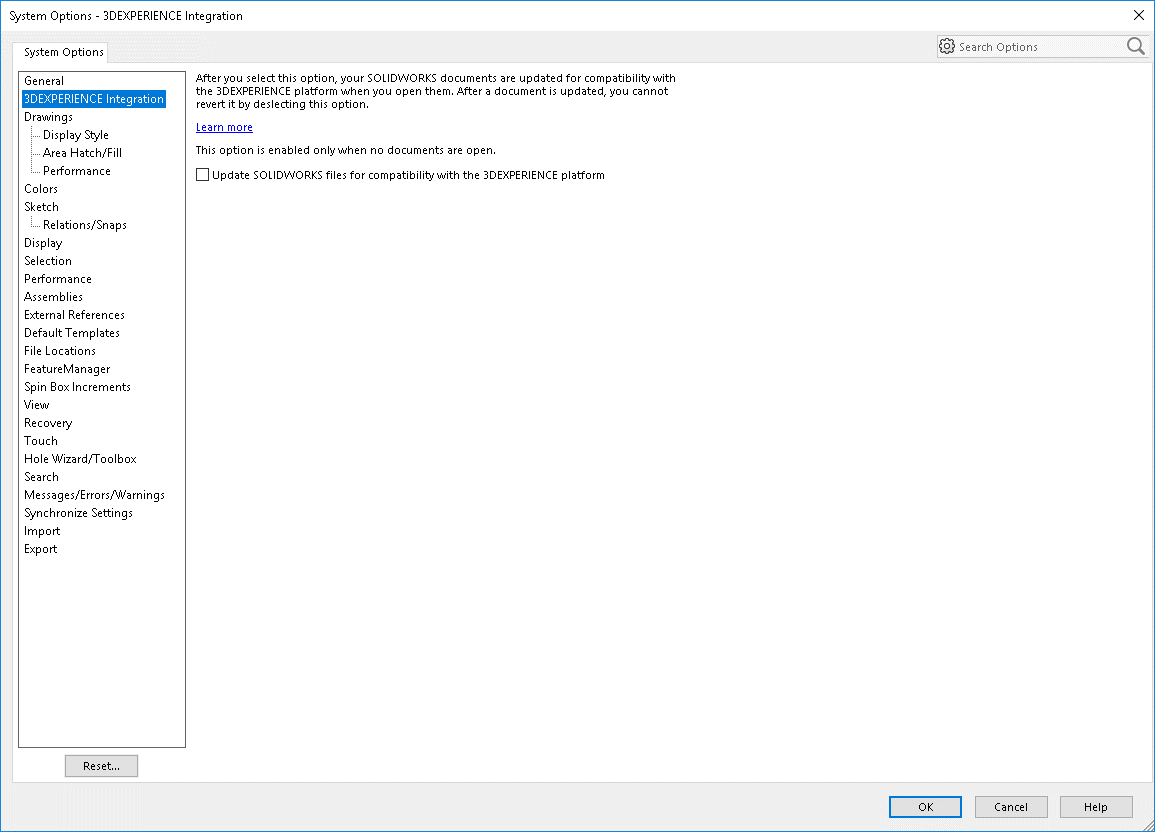

System Options > 3DEXPERIENCE Integration
This dialog is only available in SOLIDWORKS Connected.
Setting
Get/Set Methods
Return Value
or
<Value>
or
<OnFlag>
Comment
Update SOLIDWORKS files for compatibility with the 3DEXPERIENCE platform
ISldWorks::GetUserPreferenceToggle(swUserPreferenceToggle_e.swEnable3DEXPERIENCEFileCompatibilityUpdate) ISldWorks::SetUserPreferenceToggle(swUserPreferenceToggle_e.swEnable3DEXPERIENCEFileCompatibilityUpdate, <OnFlag>)
Boolean value
This option is enabled only when no documents are open
