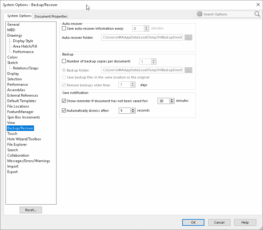

System Options > Backup/Recover
This topic contains two tables. The information in the table:
  • appearing immediately after the screen capture corresponds to the settings on that dialog.
  • titled Obsolete Enumerators contains enumerators that previously appeared on the dialog but are now obsolete.
