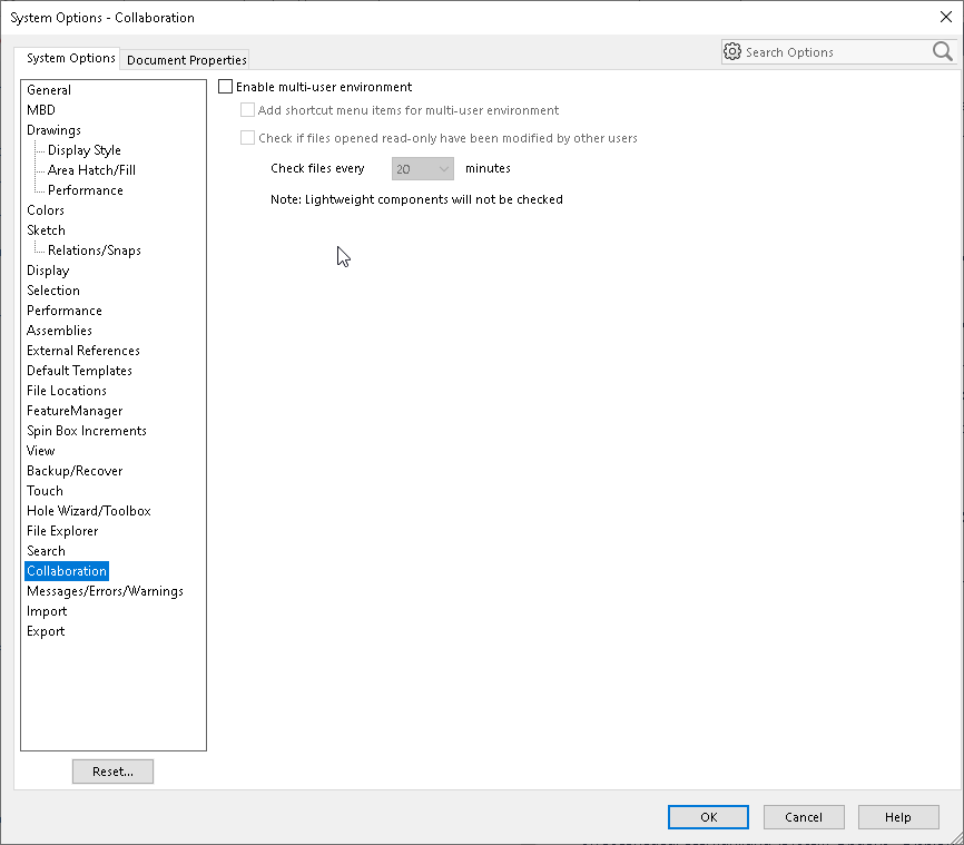

System Options > Collaboration
This topic contains two tables. The information in the table:
  • appearing immediately after the dialog corresponds to the settings on that dialog.
  • titled Obsolete Enumerators contains enumerators that previously appeared on the dialog but are now obsolete or have been moved to another location.

Enable multi-user environment
(Not supported in SOLIDWORKS Connected)
ISldWorks::GetUserPreferenceToggle(swUserPreferenceToggle_e.swCollabEnableMultiuser) ISldWorks::SetUserPreferenceToggle(swUserPreferenceToggle_e.swCollabEnableMultiuser, <OnFlag>)
Boolean value
Specifies whether to  enable multi-user environment
Add shortcut menu items for multi-user environment
ISldWorks::GetUserPreferenceToggle(swUserPreferenceToggle_e.swCollabAddShortcutMenuItems) ISldWorks::SetUserPreferenceToggle(swUserPreferenceToggle_e.swCollabAddShortcutMenuItems, <OnFlag>)
Boolean value
Specifies whether to add shortcut menu items for multi-user environment
Check if files opened read-only have been modified by other users
ISldWorks::GetUserPreferenceToggle(swUserPreferenceToggle_e.swCollabCheckReadOnlyModifiedByOthers) ISldWorks::SetUserPreferenceToggle(swUserPreferenceToggle_e.swCollabCheckReadOnlyModifiedByOthers, <OnFlag>)
Boolean value
Specifies whether to check if files opened read-only have been modified by others; works with swUserPreferenceIntegerValue_e.swCollabCheckReadOnlyModifiedInterval
Check files every <n> minutes
ISldWorks::GetUserPreferenceIntegerValue(wUserPreferenceIntegerValue_e.swCollabCheckReadOnlyModifiedInterval)
ISldWorks::SetUserPreferenceIntegerValue(wUserPreferenceIntegerValue_e.swCollabCheckReadOnlyModifiedInterval, swCollabCheckReadOnlyModifiedInterval_e .<Value>)
See swCollabCheckReadOnlyModifiedInterval_e for valid options
Works with swUserPreferenceToggle_e.swCollabCheckReadOnlyModifiedByOthers
