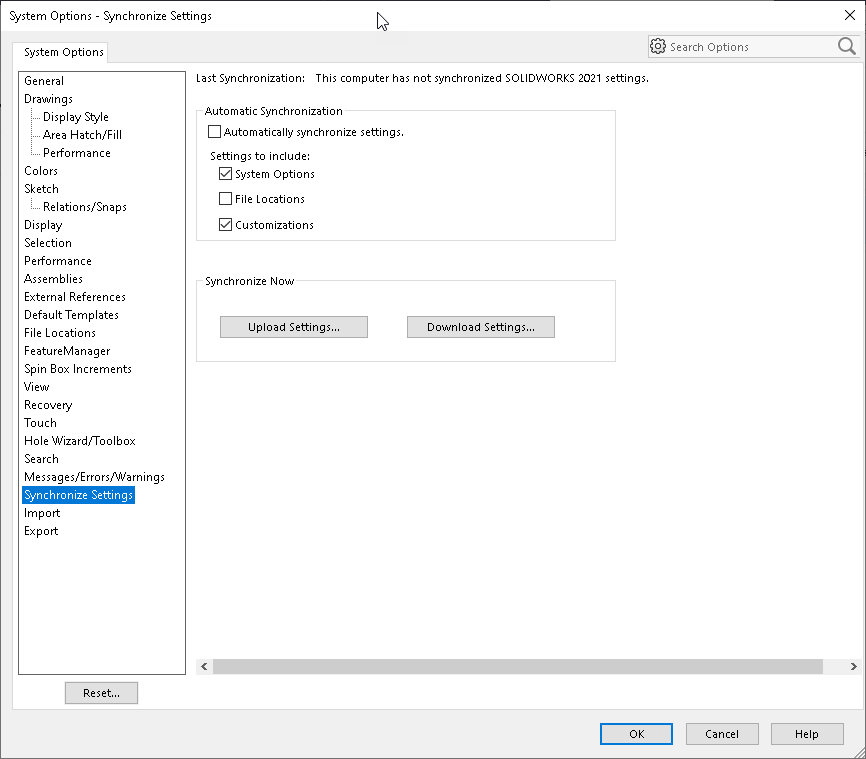

System Options > Synchronize Settings
This dialog is only available in SOLIDWORKS Connected.
Setting |
Get/Set Methods |
Return value
or
<Value>
or
<OnFlag> |
Comment |
Last Synchronization (SOLIDWORKS Connected only) |
ISldWorks::GetUserPreferenceStringValue(swUserPreferenceStringValue_e.swLastSynchronizationTimeStamp)
String value |
Automatic Synchronization - Automatically synchronize settings (SOLIDWORKS
Connected only) |
ISldWorks::GetUserPreferenceToggle(swUserPreferenceToggle_e.swAutomaticSyncSettings)
ISldWorks::SetUserPreferenceToggle(swUserPreferenceToggle_e.swAutomaticSyncSettings,
<OnFlag>) |
Boolean value |
When set to true, specified settings to include are automatically
synchronized when logging in and out of SOLIDWORKS Connected |
Automatic Synchronization - Settings to include - System Options
ISldWorks::GetUserPreferenceToggle(swUserPreferenceToggle_e.swAutoSyncSettingsToInclude_SystemOptions)
ISldWorks::SetUserPreferenceToggle(swUserPreferenceToggle_e.swAutoSyncSettingsToInclude_SystemOptions,
<OnFlag>) |
Boolean value
Valid only if swUserPreferenceToggle_e.swAutomaticSyncSettings is set to true |
Automatic Synchronization - Settings to include - File Locations
ISldWorks::GetUserPreferenceToggle(swUserPreferenceToggle_e.swAutoSyncSettingsToInclude_FileLocations)
ISldWorks::SetUserPreferenceToggle(swUserPreferenceToggle_e.swAutoSyncSettingsToInclude_FileLocations,
<OnFlag>) |
Boolean value |
Automatic Synchronization - Settings to include - Customizations (SOLIDWORKS
Connected only) |
ISldWorks::GetUserPreferenceToggle(swUserPreferenceToggle_e.swAutoSyncSettingsToInclude_Customizations)
ISldWorks::SetUserPreferenceToggle(swUserPreferenceToggle_e.swAutoSyncSettingsToInclude_Customizations,
<OnFlag>) |
Boolean value |
Synchronize Now - Upload Settings... (SOLIDWORKS
Connected only) |
ISldWorks::UploadToMySolidWorksSettings |
Integer value |
Synchronize Now - Download Settings... (SOLIDWORKS
Connected only) |
ISldWorks::DownloadFromMySolidWorksSettings |
Integer value |
