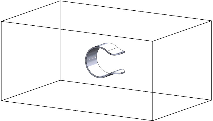

It is important to accurately specify the mold dimensions for the
main body of the mold, excluding the ejector housing, so that the thermal capacity
of the mold is properly represented in the analysis. Created purely for simulation
purposes, the virtual mold is a domain that represents the mold as a rectangular
volume in space.
