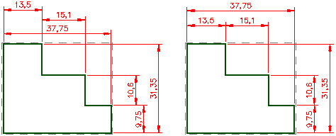

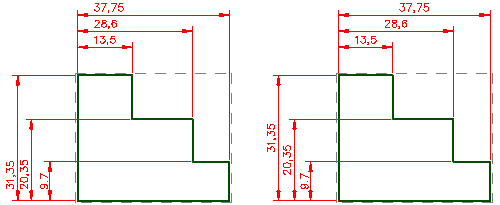

Examples of Automatically Arranging Dimensions These images show dimensioned geometry before and after automatic arrangement: Dimensions are spaced from smallest (closest to the geometry) to largest. Dimensions are aligned to each other. Dimensions are spaced equally and aligned to each other. Dimension text is centered between extension lines. Parent topicAutomatically Arranging Dimensions
