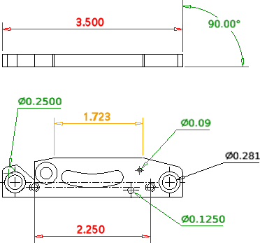

Lists the number of
extracted annotations that were removed from the revised
file. In the Table Manager, on the
Characteristics
tab, deleted characteristics appear in red. Right-click
the characteristics to delete and click . This deletes the characteristic and
renumbers the remaining characteristics. If you do not
delete the characteristics, they remain highlighted in
red.

Lists the number of
extracted annotations that were modified in the revised
file. You can:
- Update
existing characteristic(s) with new
values. Updates the values of the
original characteristics using the established
balloon and characteristic numbers from the revised
file.
- Do not
update existing characteristic(s) with new
values. Makes no changes to the
characteristics. This may cause a discrepancy
between the values in the file and the values on the
Characteristic tab in the Table
Manager.
Lists the number of
extracted annotations that have changed in the revised
Characteristics
tab, deleted characteristics appear in yellow.
Right-click the characteristics to update and click
Update Characteristic
Value. If you do not update the values,
they remain highlighted in yellow.

Lists the number of
characteristics in the file that were not extracted in the
previously saved state of the project (even in the
characteristic was present in the previous revision). You can:
- Automatically extract new
annotations. Extracts and balloons all
new characteristics (does not change established
numbering).
- Do not
extract new annotations. Does not
extract the new characteristics. The characteristics
appear as unextracted (gray) when automated revision
processing finishes.
Lists the number of
extracted annotations that were added in the revised file. In the Table Manager, on the Characteristics tab, new
characteristics appear in green. Right-click the
characteristics to add and click
