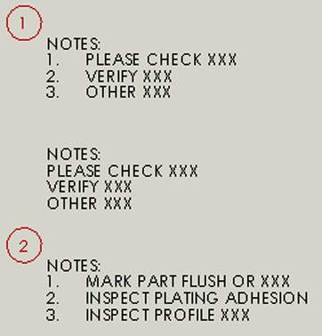

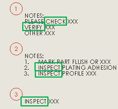

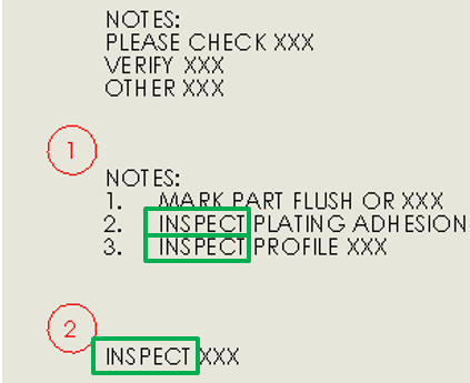

Example 1
With this string, two notes are ballooned based on the extraction criteria:
INSPECT
Example 2
With this string, three notes are ballooned based on the extraction criteria:
INSPECT|CHECK|VERIFY

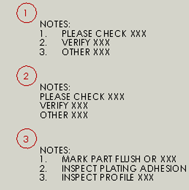

Example
3
criteria:
(\d{1,3}\.\s{0,3}.*)|<MOD-DIAM>.*|^R\s{0,2}\.\d{1,4}.*|^RUN@.*|(\.\d{1,3}\s{0,3}X\s{0,3}\d{1,3}.*)|MARK.*
If you used no extraction criteria, all notes are extracted:
