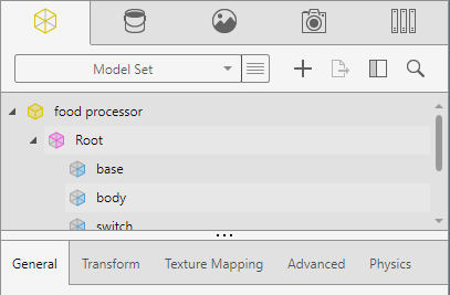

Model Tree
The model tree is near the top of the Models
tab in the Palette. It contains
the names of the models in the scene and the parts within each model.
- In the list near the top of the Models tab,
select the model set containing the models you want in the scene.
Next to the model name, click
to access the controls to
duplicate
, add
, or rename
the model.

- To select a model and display its parameters in the
Models tab, do one of the following:
- In the model tree of the Models
tab, select the model.
- Click
, and select the model
in the scene. When you click the
Models tab, the Selection
Tool automatically changes to
Model mode.
When you select a model, it is outlined in
yellow.
- To select a part and display its parameters in the
tab, select the part.
- Click
, and select the part
in the scene.
When you select a part, it is outlined in blue.
- When you select a group, it is outlined in purple.
