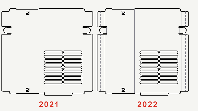

In flat pattern drawing views of sheet metal parts, bend lines are
independent of sketches.
You can hide sketches
while keeping bend lines visible. Previously, if you hid sketches in a
flat pattern view, the bend lines would also be hidden.
Click or Sketches.
