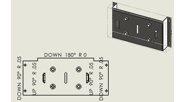

When you create a predefined view in a drawing, you can specify
the model orientation as trimetric, dimetric, or flat pattern. This is helpful if you
need drawing templates that contain specific predefined views.
Click Predefined
View
or . In the PropertyManager, under
Orientation, select Flat
pattern, Trimetric, or Dimetric.
