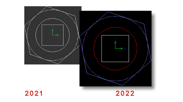

Colors in Exported Sketches When you save a part or drawing as a DWG or DXF file, sketch entities appear in the assigned sketch color in the exported file. The colors are also supported for sketches in flat patterns of sheet metal parts if you specify Flat pattern colors in Tools > Options > Document Properties > Sheet Metal MBD. Parent topicImport/Export Import Performance Improvements Importing Selective IFC Entities from IFC Files Opening Non-Native Assemblies with Reference Files Located in Different Folders
