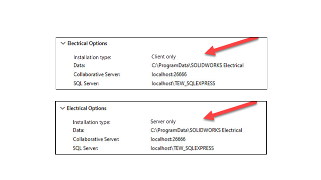

The SOLIDWORKS
Installation Manager makes it more apparent if you are installing the Client only or if you are including Server components for SOLIDWORKS
Electrical.
This
helps organizations that share SOLIDWORKS Electrical data and databases on a server
instead of
on
individual
machines. For this case, administrators install Server components once on a server and install the Client only on all machines running SOLIDWORKS
Electrical.
Updates include:
- The Summary page of the
SOLIDWORKS Installation Manager identifies if you are installing a Client Only or if you are including Server components.
- The SQL Server options display only the options that are appropriate for a
Client only
installation.
- When the SOLIDWORKS Installation Manager cannot connect to the
existing SQL Server, a warning displays, but the installation continues.
You can connect to the SQL Server later in SOLIDWORKS
Electrical.
- The Client and Server options for installing SOLIDWORKS
Electrical are also available in the Administrative Image Option Editor.
