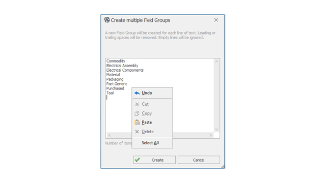

You can create
multiple field groups at once, by entering multiple lines or copying and pasting from a
text-based file (such as .xlsx, .txt, or
.csv). You can Shift + or
Ctrl + select multiple field groups to delete
them.
To create multiple field groups:
- In the Field Groups dialog box, click the
New tab and click Create multiple Field
Groups.
- In the Create multiple Field Groups dialog box, copy and
paste field groups from a text-based file.
- Click
