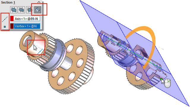

In parts and assemblies, you can rotate a section view plane about an
axis, temporary axis,
hole,
or cylindrical face.
In the Section
View PropertyManager, under Section, click Section About Axis
. Select an axis,
hole,
or cylindrical face
plus a point or vertex
to create the section view plane.
