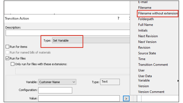

  • In the Transition Action dialog box, when you specify Type as Set Variable, you can define the value of the selected variable as Filename without extension.
