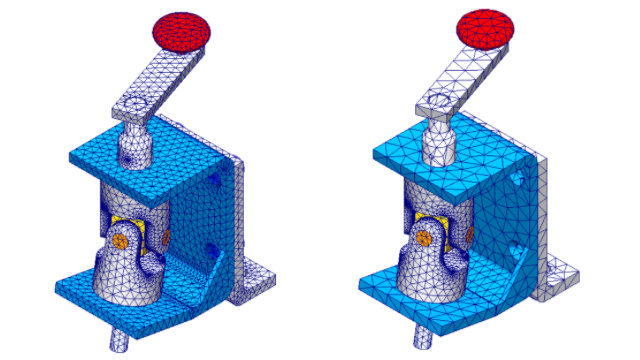

Using the Blended
Curvature-based mesher, you can apply mesh control that has a larger element size than
the global mesh size.
Create a coarser mesh for bodies that may be not critical for the simulation to reduce
the analysis time. Previously, you could only apply a mesh control to refine the mesh of
selected bodies and geometric entities.
