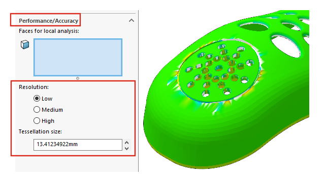

To
optimize the results of a thickness analysis, you can specify the resolution, regardless
of the model size. Previously, the resolution used depended on the model
size.
Enable the SOLIDWORKS Utilities add-in. Click
. In the PropertyManager, under
Performance/Accuracy,
for
Resolution, select
Low,
Medium, or
High. Under
Tesselation
size, the value updates to reflect the suggested values. To customize
the resolution, enter a custom value. Consider using custom values for models that have
a large bounding box or to define a specific resolution.
The custom
Tesselation size value cannot exceed the
suggested value for the Low
resolution.
