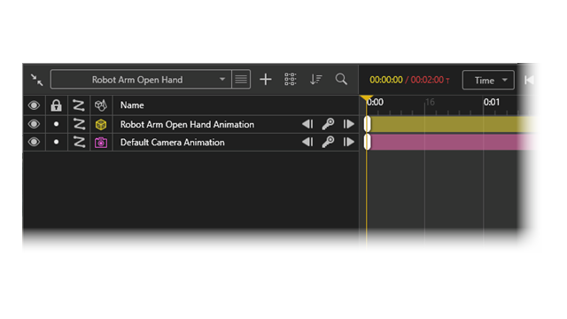

![](fxp1619023765792.image)
Animations are improved in areas such as motion studies,
organization, keyframes, and
cameras.
Improvements include:
- Support for multiple motion studies per model set. You can import
multiple SOLIDWORKS motion studies for SOLIDWORKS parts and
assemblies.
This is helpful because you:
- Do not have to reanimate the part or assembly in
SOLIDWORKS Visualize.
- Can use tools such as Mate
Controller and flexible subassemblies.
- You can organize animated items in each animation with
grouping
functionality. You can also use tools to sort and filter the animation
timeline.
- Suppress or unsuppress individual keyframes in animations and
copy keyframe properties from one keyframe to another.
- Use multiple cameras in animation sequences to switch among
multiple cameras during animation playback.
