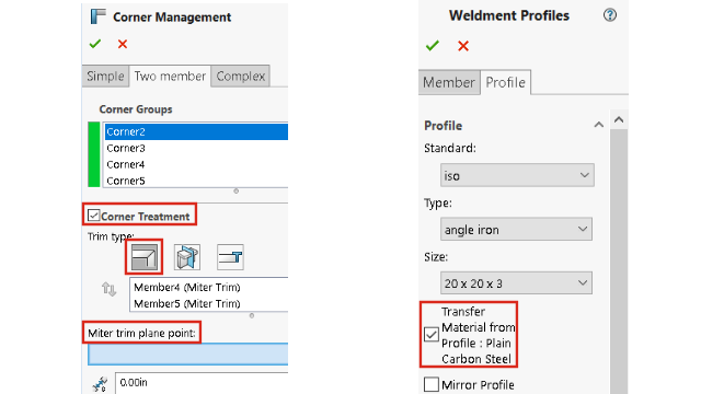

Improvements
in the Complex
Corner
PropertyManager
provide
a clear workflow to use the Corner
Management
functionality.
- On
the
Two member tab, under Corner Management, the Miter trim
plane point lets you select a point from the graphics area to
create
the miter trim through
the
selected point.
- Options related to Corner Treatment
are
displayed only if you select the Corner
Treatment check
box.
- Icons
for planar trim options are smaller than icons for trim type to depict the
hierarchy.
- Transfer Material from
Profile transfers the material of the selected library profile
if the profile has
a
material
assigned to it.
