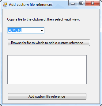

Add Custom File Reference Example (C#)
This example shows how to add a custom file reference to a file in the vault.
NOTE: If using the primary interop assembly provided with SOLIDWORKS PDM Professional, see Using .NET Framework 4.0 in Stand-alone Applications.
// Preconditions:
// 1. Start Microsoft Visual Studio.
//    a. Click File > New > Project > Visual C# > Windows Forms Application.
//    b. Type CustRefCSharp in Name.
//    c. Click Browse and navigate to the folder where to create
//       the project.
//    d. Click OK
//    e. Click Show All Files in the Solution Explorer toolbar and expand
//       Form1.cs in the Solution Explorer.
//    f. Create a form similar to the form shown above and change:
//       1. Top label to VaultsLabel.
//       2. Combo box to VaultsComboBox.
//       3. Browse button to BrowseButton.
//       4. List box to CustRefListBox.
//       5. Add custom file reference button to AddCustomFileReference.
//    g. Replace the code in Form1.cs with this code.
//    h. Replace the code in Form1.Designer.cs with this code.
// 2. Add EPDM.Interop.epdm.dll as a reference (right-click the project
//    name in the Solution Explorer, click Add Reference, click
//    Assemblies > Framework in the left-side panel, browse to the top folder of
//    your SOLIDWORKS PDM Professional installation, locate and click
//    EPDM.Interop.epdm.dll, click Open, click Add, and click Close).
// 3. Right-click EPDM.Interop.epdm in References, click Properties, and set
//    Embed Interop Types to False to handle methods that pass arrays of
//    structures.
// 4. Click Debug > Start Debugging or press F5.
// Postconditions:
// 1. The Add custom references dialog displays.
// 2. Select a vault.
// 3. Click Browse for file to which to add custom reference
//    locate and click a file in the vault, and click Open.
//    The file is checked out.
// 4. In a view of the selected vault, right-click a file and click Copy.
// 5. In the Add custom references dialog, click Add custom file reference.
//    The file that was copied to the clipboard is added as a custom
//    reference to the checked-out file.
// 6. In the Create File References dialog, click OK.
//    The file is checked in.
// 7. In the Edit User-Defined File References dialog, click OK.
// 8. Close the Add custom references dialog.
