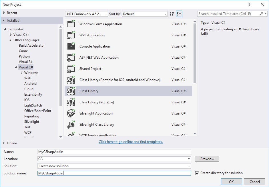

Create C# project with Visual Studio
  • Open Visual Studio
  • File -> New -> Project
  • Select Visual C# -> Class Library
Click OK.

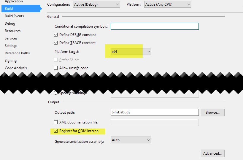

In the solution tree -> Go to project properties.
Verify that solution platform is x64
Otherwise create it.

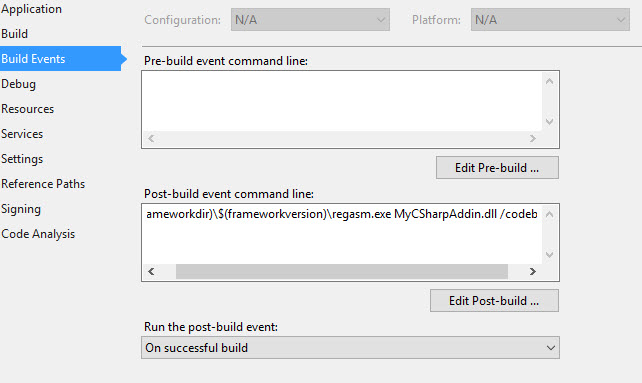

In Build tab, select platform x64 and check "Register for COM interop"
In the Build Events tab, In the Post-build events command line Add this comand line: C:\WINDOWS\Microsoft.NET\Framework64\$(frameworkversion)\regasm.exe "$(TargetPath)" /codebase

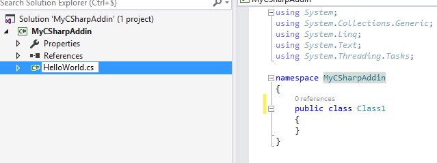

Rename Class1.cs file with an appropriate name for the add-in.

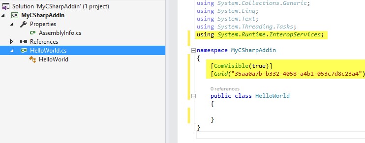

Open Assemblyinfo.cs, cut selected lines below:
In your Class interface (HelloWorld.cs):
  • Paste previously copied information
  • Verify that you have ComVisible(true) and not ComVisible(false).
  • Add: using System.Runtime.InteropServices;
Like in screen shot below:

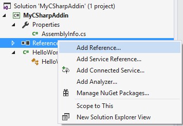

Include reference to EwAPIX.dll
Right click on Reference and select Add reference...
Browse to the location of EwAPIX.dll

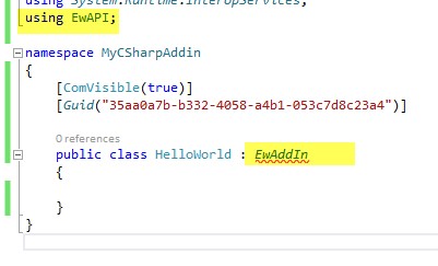

Add: using EwAPI;
Inherit your main class from EwAddIn
