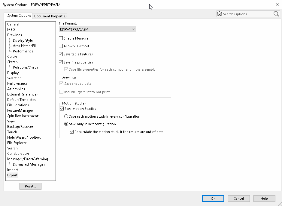

System Options > Export > EDRW/EPRT/EASM
This topic contains two tables. The information in the table:
  • appearing immediately after the screen capture corresponds to the settings on that dialog.
  • titled Obsolete Enumerators contains enumerators that previously appeared on the dialog but are now obsolete.
To display the dialog:
Click Tools > Options > System Options > Export > EDRW/EPRT/EASM in File Format.
- or -
  1. Click File > Save As.
  2. In Save as type, select eDrawings.
  3. Click Options.
Exporting in the EDRW/EPRT/EASM file format is not supported in SOLIDWORKS Connected.
