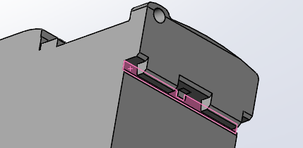

7. In the wizard, select the Reference
Name option (For
Rail) and click the Add button
to define the mate reference.
8. Select the top face in reference with the rail.
![](Screenshot/SWComponentWizard01.png)

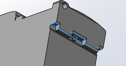

9. Select the front face in reference with the rail.
![](Screenshot/SWComponentWizard02.png)
10. Click on the green checkmark to validate.

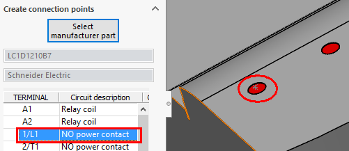

2. Select the Point
Type option (CPoint from manufacturer
part) and click the Add button.
3. In the dockable panel, click the Select manufacturer part button.
4. In the Manufacturer
part search dialog box, search for the lc1d1210b7
manufacturer part from Schneider
Electric in the Contactor relays
class.
5. In the dockable panel, select the Terminal / Circuit
and click the corresponding component terminal in the graphical area.

6. Validate each connection point by clicking on the
green checkmark.
