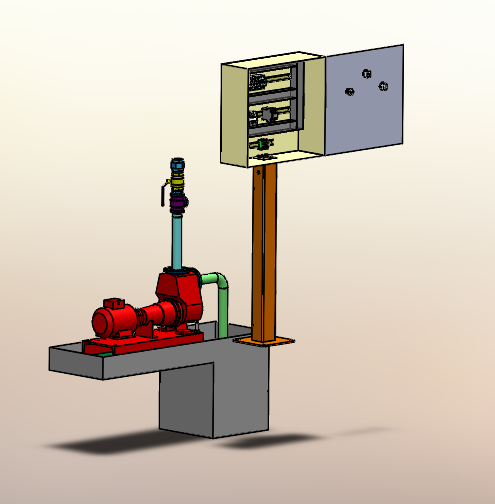

Handling the cabinet
![](Screenshot/SWCableGland01.png)
Before to route cables and wires, it is necessary to modify
the existing assemblies. In the Cabinet
assembly, you must add the cable glands and the routing
paths, in the Pump unit,
you must add the routing paths, and define the origin and the
destination for the cables. |

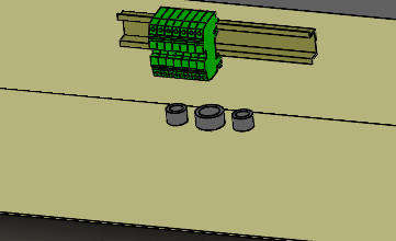

1. Open the Cabinet
assembly.
2. Add the three cable glands on the bottom of the
cabinet (a 20 cable gland in the center and a 14 cable gland on both side)
using the Insert Components of
the Assembly menu.
The cable gland files are available on the data folder of
SOLIDWORKS Electrical: ...\ProgramData\SOLIDWORKS Electrical\SOLIDWORKS\sldPrt |

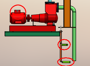

Handling the Pump Unit
![](Screenshot/SWRoutePathCable01.png)
1. Open the Pump
Unit assembly.
2. Insert the EW_PUMP_TANK_PANEL_SUPPORT.SLDASM
file, stored in the project folder (...\ProgramData\SOLIDWORKS Electrical\Projects\XX\PUMP),
using the Insert Components command
of the Assembly menu.
3. Associate B1
to the first sensor, B2 to the
second sensor and PU1 to the motor
of the pump.
![](Screenshot/SWAssociate01.png)
The Associate
command is available in the contextual menu of the component in
the left dockable panel. |
4. Insert the Cabinet
and manage the reference mates.
![](Screenshot/Video.png)
Defining
the origin and the destination of the cables
The electrical project has 3 cables:
W1 running from the
1st cable gland to the sensor B1.
W2 running from the
2nd cable gland to the sensor B2.
W3 running from the
3rd cable gland to the pump motor. |
