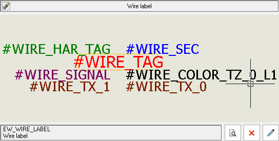

The wire label mainly displays the wire number. Ensure beforehand that
wire numbering has been launched.
![](Screenshot/WireLabel01.gif)
The wire labels are represented by a symbol
and attributes that can display the data or properties
associated with the wire.
The wire labels have a contextual menu allowing you to, among other
things, edit the wire properties.
Configuration of the symbol to
be used

Symbols representing wire labels do not have circuits or connection
points. In symbol properties,
select Wire labels in the Symbol type parameter.
