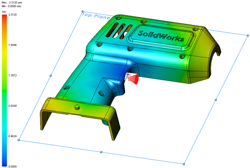

Result Review
Shows the recommended injection
locations and a preview of the fill plot. Predicts how the
plastic material fills the mold based on the recommended
injection locations.
![](qcg1623880696798.image) |
A red glyph points to a potential gate location
selected by the Injection Location
Advisor. |
