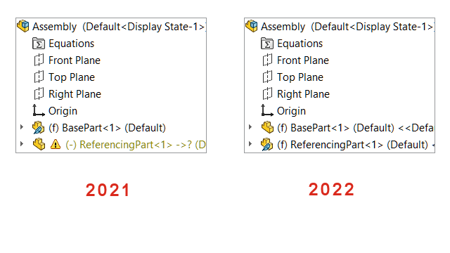

When
you open an assembly in lightweight mode, components referenced by equations in the
top-level assembly display as resolved.
When you resolve a part or subassembly
that has equations and the equations reference another lightweight component, the
referenced component is resolved.
