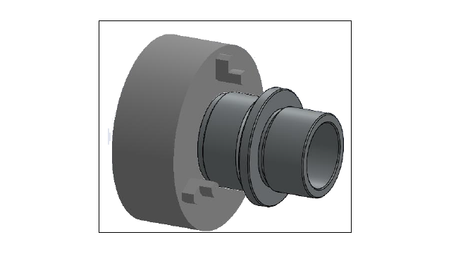

Assembly Support for Turn
Turn mode supports assemblies that contain a single Turn part model.
You must define the following:
  • In the Machine tab of the Machine dialog box, tthe Main Spindle Coordinate system for machining the parts in the assembly
  • Under the Stock Manager node, the stock for the individual parts that will be listed as subnodes
  • In the Manage Parts dialog box, the turn part, the spindle designation, origin of the coordinate system and turn feature section plane
  • In the Spindle work coordinate dialog box, the programmable offsets for the main spindle of the machine
