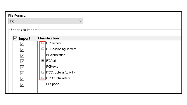

To import selective IFC entities from IFC files:
- In an IFC file, click .
- Under File Format, select
IFC.
- Under Entities to import, expand the
IFC
entities under Classification.
- Under Import, select the IFC entities to import.
- Click OK.
After you open the IFC file, only the
IFC entities that you
specified
in the System Options dialog box are imported.
