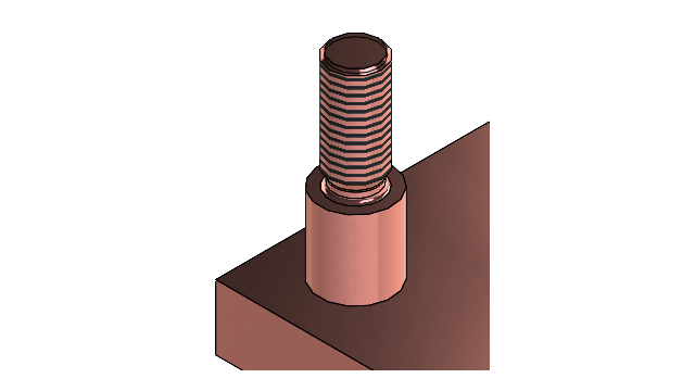

You can use the Stud
Wizard to create external threaded stud features. This tool works similar to the Hole
Wizard. You define the stud parameters then position the studs on the model. You can
also apply thread parameters to existing circular studs.
To create stud features, click Stud Wizard
(Features toolbar) or
. To view the threads, click
and under Display Filter, select
Cosmetic threads or Shaded cosmetic threads.
