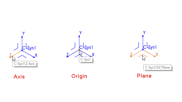

You
can reference all parts of coordinate systems, such as planes, axes, and origin, in
downstream features. For example, you can sketch on the XY plane of a coordinate system or use the Z axis of a coordinate system as the axis for a revolve
feature.
In a part or
assembly, click
and create the coordinate system. Hover over a plane,
axis, or the origin to highlight each entity. This functionality is useful for actions
such as sketching, mating, and more.
To see this functionality, show coordinate
systems. Click .
