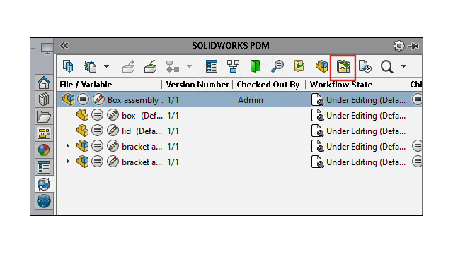

Opening a Drawing from the SOLIDWORKS PDM Add-In
In the SOLIDWORKS PDM Add-in, you can open a drawing of a SOLIDWORKS part or assembly file.
To open a drawing, click on the SOLIDWORKS PDM task pane or right-click the part or assembly and click Open Drawing.
The drawings may not be locally cached, can have a different name from the part or assembly file, and can exist in a different folder.
