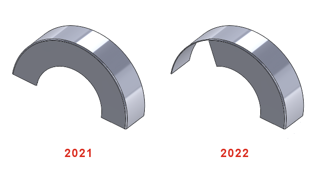

If you create an edge
flange on a nonlinear edge, you can edit the sketch for the nonlinear edge
flange.
In a sheet metal
part, select a nonlinear edge and click Edge
Flange
(Sheet Metal toolbar). In the
PropertyManager, click Edit Flange Profile and
edit the sketch.
