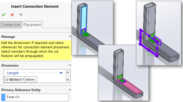

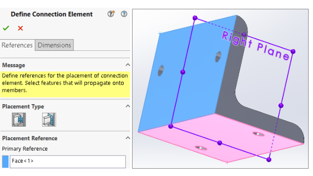

Connection Element for Structure Systems SOLIDWORKS supports connection elements for structure systems. You can define the connection element and insert it on a structure system part. Contents Defining and Inserting Connection Elements SOLIDWORKS supports connection elements for structure systems. You can define the connection element and insert it on a structure system part. Connection Definition PropertyManager - References Tab The References tab in the Connection Definition PropertyManager lets you create a connection element for a structure system from a part. Connection Definition PropertyManager - Dimensions Tab You can select the dimensions of the connection element and then modify them when you insert the connection element. Insert Connection PropertyManager This PropertyManager lets you insert the connection element on a structure system part. Parent topicStructure System and Weldments End Cap Support Custom Properties Architecture Complex Corner PropertyManager Secondary Members Properties Dialog Box
