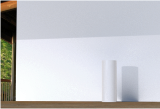

    A plane is at the back wall of the stage in the backplate image When you specify the plane as a shadow catcher, you see the backplate image with the shadow cast more naturally
