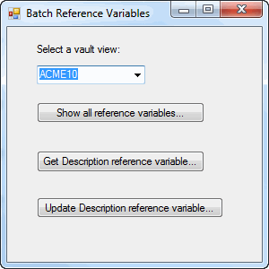

// Postconditions:
//  1. The Batch Reference Variables dialog box displays.
//     a. Select a vault view.
//     b. Click Show all reference variables.
//        1. In the Select Parent File dialog, select the assembly file identified
//           in Preconditions step 8 and click Open.
//        2. In the Select Child File dialog, select a part file referenced by the
//           assembly file and click Open.
Displays all of the reference variables for all configurations.

namespace BatchGetSetRefVariables_CSharp
    partial class Form1
        /// <summary>
        /// Required designer variable.
        /// </summary>
        private System.ComponentModel.IContainer components = null;
        /// <summary>
        /// Clean up any resources being used.
        /// </summary>
        /// <param name="disposing">true if managed resources should be disposed; otherwise, false.</param>
        protected override void Dispose(bool disposing)
            if (disposing && (components != null))
                components.Dispose();
            base.Dispose(disposing);
        #region Windows Form Designer generated code
        /// <summary>
        /// Required method for Designer support - do not modify
        /// the contents of this method with the code editor.
        /// </summary>
        private void InitializeComponent()
            this.VaultsComboBox = new System.Windows.Forms.ComboBox();
            this.VaultsLabel = new System.Windows.Forms.Label();
            this.Button1 = new System.Windows.Forms.Button();
            this.Button2 = new System.Windows.Forms.Button();
            this.Button3 = new System.Windows.Forms.Button();
            this.SuspendLayout();
            //VaultsComboBox
            this.VaultsComboBox.FormattingEnabled = true;
            this.VaultsComboBox.Location = new System.Drawing.Point(33, 43);
            this.VaultsComboBox.Name = "VaultsComboBox";
            this.VaultsComboBox.Size = new System.Drawing.Size(121, 21);
            this.VaultsComboBox.TabIndex = 0;
            //VaultsLabel
            this.VaultsLabel.AutoSize = true;
            this.VaultsLabel.Location = new System.Drawing.Point(30, 18);
            this.VaultsLabel.Name = "VaultsLabel";
            this.VaultsLabel.Size = new System.Drawing.Size(100, 13);
            this.VaultsLabel.TabIndex = 1;
            this.VaultsLabel.Text = "Select a vault view:";
            //Button1
            this.Button1.Location = new System.Drawing.Point(33, 84);
            this.Button1.Name = "Button1";
            this.Button1.Size = new System.Drawing.Size(187, 23);
            this.Button1.TabIndex = 2;
            this.Button1.Text = "Show all reference variables...";
            this.Button1.UseVisualStyleBackColor = true;
            this.Button1.Click += new System.EventHandler(Button1_Click);
            //Button2
            this.Button2.Location = new System.Drawing.Point(33, 138);
            this.Button2.Name = "Button2";
            this.Button2.Size = new System.Drawing.Size(187, 24);
            this.Button2.TabIndex = 3;
            this.Button2.Text = "Get Description reference variable...";
            this.Button2.UseVisualStyleBackColor = true;
            this.Button2.Click += new System.EventHandler(Button2_Click);
            //Button3
            this.Button3.Location = new System.Drawing.Point(33, 190);
            this.Button3.Name = "Button3";
            this.Button3.Size = new System.Drawing.Size(208, 23);
            this.Button3.TabIndex = 4;
            this.Button3.Text = "Update Description reference variable...";
            this.Button3.UseVisualStyleBackColor = true;
            this.Button3.Click += new System.EventHandler(Button3_Click);
            //Form1
            this.AutoScaleDimensions = new System.Drawing.SizeF(6f, 13f);
            this.AutoScaleMode = System.Windows.Forms.AutoScaleMode.Font;
            this.ClientSize = new System.Drawing.Size(284, 262);
            this.Controls.Add(this.Button3);
            this.Controls.Add(this.Button2);
            this.Controls.Add(this.Button1);
            this.Controls.Add(this.VaultsLabel);
            this.Controls.Add(this.VaultsComboBox);
            this.Name = "Form1";
            this.Text = "Batch Reference Variables";
            this.Load += new System.EventHandler(this.Form1_Load);
            this.ResumeLayout(false);
            this.PerformLayout();
