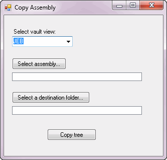

// 4. Ensure that the vault root folder contains an assembly that
//    is checked in with its referenced parts and drawings.
// 5. Create a destination folder called New Folder in the vault.
// 6. Click Debug > Start Debugging or press F5.
// Postconditions:
// 1. Displays the Copy Assembly dialog box.
//    a. Select a vault view.
//    b. Click Select assembly
//       Locate and double-click an assembly.
//    c. Click Select a destination folder.
//       1. Locate and select New Folder.
//       2. Click OK.
//    d. Click Copy tree.
//       The Copy Tree dialog shows the files to copy.
//    e. Click Copy
//       The Copying tree progress bar appears.
//    f. Inspect the destination folder.
// 2. Close the Copy Assembly dialog box.

        private void InitializeComponent()
            this.VaultsLabel = new System.Windows.Forms.Label();
            this.VaultsComboBox = new System.Windows.Forms.ComboBox();
            this.BrowseAssembly = new System.Windows.Forms.Button();
            this.ListBox = new System.Windows.Forms.ListBox();
            this.CopyTree = new System.Windows.Forms.Button();
            this.OpenFileDialog = new System.Windows.Forms.OpenFileDialog();
            this.BrowseDestFolder = new System.Windows.Forms.Button();
            this.listBox1 = new System.Windows.Forms.ListBox();
            this.SuspendLayout();
            // VaultsLabel
            this.VaultsLabel.AutoSize = true;
            this.VaultsLabel.Location = new System.Drawing.Point(13, 26);
            this.VaultsLabel.Name = "VaultsLabel";
            this.VaultsLabel.Size = new System.Drawing.Size(94, 13);
            this.VaultsLabel.TabIndex = 0;
            this.VaultsLabel.Text = " Select vault view:";
            // VaultsComboBox
            this.VaultsComboBox.FormattingEnabled = true;
            this.VaultsComboBox.Location = new System.Drawing.Point(16, 42);
            this.VaultsComboBox.Name = "VaultsComboBox";
            this.VaultsComboBox.Size = new System.Drawing.Size(121, 21);
            this.VaultsComboBox.TabIndex = 1;
            // BrowseAssembly
            this.BrowseAssembly.Location = new System.Drawing.Point(16, 85);
            this.BrowseAssembly.Name = "BrowseAssembly";
            this.BrowseAssembly.Size = new System.Drawing.Size(121, 23);
            this.BrowseAssembly.TabIndex = 3;
            this.BrowseAssembly.Text = "Select assembly...";
            this.BrowseAssembly.UseVisualStyleBackColor = true;
            this.BrowseAssembly.Click += new System.EventHandler(this.BrowseButton_Click);
            // ListBox
            this.ListBox.FormattingEnabled = true;
            this.ListBox.HorizontalScrollbar = true;
            this.ListBox.Location = new System.Drawing.Point(16, 114);
            this.ListBox.Name = "ListBox";
            this.ListBox.SelectionMode = System.Windows.Forms.SelectionMode.None;
            this.ListBox.Size = new System.Drawing.Size(259, 30);
            this.ListBox.TabIndex = 4;
            // CopyTree
            this.CopyTree.Location = new System.Drawing.Point(77, 293);
            this.CopyTree.Name = "CopyTree";
            this.CopyTree.Size = new System.Drawing.Size(98, 23);
            this.CopyTree.TabIndex = 5;
            this.CopyTree.Text = "Copy tree";
            this.CopyTree.UseVisualStyleBackColor = true;
            this.CopyTree.Click += new System.EventHandler(this.AddFiles_Click);
            // OpenFileDialog
            this.OpenFileDialog.Title = "Open";
            // BrowseDestFolder
            this.BrowseDestFolder.Location = new System.Drawing.Point(16, 181);
            this.BrowseDestFolder.Name = "BrowseDestFolder";
            this.BrowseDestFolder.Size = new System.Drawing.Size(142, 23);
            this.BrowseDestFolder.TabIndex = 6;
            this.BrowseDestFolder.Text = "Select destination folder...";
            this.BrowseDestFolder.UseVisualStyleBackColor = true;
            this.BrowseDestFolder.Click += new System.EventHandler(this.BrowseDestFolder_Click);
            // listBox1
            this.listBox1.FormattingEnabled = true;
            this.listBox1.Location = new System.Drawing.Point(16, 211);
            this.listBox1.Name = "listBox1";
            this.listBox1.SelectionMode = System.Windows.Forms.SelectionMode.None;
            this.listBox1.Size = new System.Drawing.Size(259, 30);
            this.listBox1.TabIndex = 7;
            // Form1
            this.AutoScaleDimensions = new System.Drawing.SizeF(6F, 13F);
            this.AutoScaleMode = System.Windows.Forms.AutoScaleMode.Font;
            this.ClientSize = new System.Drawing.Size(317, 363);
            this.Controls.Add(this.listBox1);
            this.Controls.Add(this.BrowseDestFolder);
            this.Controls.Add(this.CopyTree);
            this.Controls.Add(this.ListBox);
            this.Controls.Add(this.BrowseAssembly);
            this.Controls.Add(this.VaultsComboBox);
