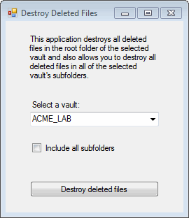

This example shows how to create an application that displays a form in which a user can select the vault in whose root folder and subfolders all deleted files will be permanently destroyed. The user must have permission to delete files.
NOTE: If using the primary interop assembly provided with SOLIDWORKS PDM Professional, see Using .NET Framework 4.0 in Stand-alone Applications.
IMPORTANT: Do not recreate and run this example if you do not want to destroy all deleted files in the root folder and subfolders in the selected vault. Instead, SOLIDWORKS PDM Professional suggests that you review the code to understand how you can programmatically destroy deleted files in the root folder and subfolders of a vault.

' Postconditions:
'  1. Displays the Destroy Deleted Files dialog.
'  2. Select a vault.
'  3. Optionally select the Include all subfolders check box.
'  4. Click the Destroy deleted files button.
'     A message box pops up informing you that:
'     * No deleted files were found to destroy.
'       - or -
'     * The deleted files were destroyed.
'  5. Click OK in the message box.
'  6. Close the Destroy Deleted Files dialog.
