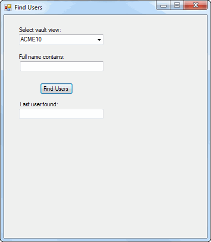

Find Users Example (VB.NET)
This example shows how to find users in the vault.
NOTE: If using the primary interop assembly provided with SOLIDWORKS PDM Professional, see Using .NET Framework 4.0 in Stand-alone Applications.
' Preconditions:
'  1. Start Microsoft Visual Studio.
'     a. Click File > New > Project > Visual Basic > Windows Forms Application.
'     b. Type FindUser in Name.
'     c. Click Browse and navigate to the folder where to create the project.
'     d. Click OK
'     e. Click Show All Files in the Solution Explorer toolbar and expand
'        Form1.vb in the Solution Explorer.
'     f. Replace the code in Form1.vb with this code.
'     g. To create the form, replace the code in Form1.Designer.vb with
'        this code.
'  2. Add EPDM.Interop.epdm.dll as a reference (right-click the project
'     name in the Solution Explorer, click Add Reference, click
'     Assemblies > Framework in the left-side panel, browse to the top folder of
'     your SOLIDWORKS PDM Professional installation, locate and click
'     EPDM.Interop.epdm.dll, click Open, click Add, and click Close).
'  3. Right-click EPDM.Interop.epdm in References, click Properties, and set
'     Embed Interop Types to False to handle methods that pass arrays of
'     structures.
'  4. Click Debug > Start Debugging or press F5.
' Postconditions:
'  1. Displays the Find Users dialog box.
'     a. Select a vault view.
'     b. In Full name contains, type a substring of the full name of a
'        user that exists in the vault.
'     c. Click Find Users.
'        A message box confirms the substring typed in Postconditions
'        step 1b.
'     d. Click OK.
'        Displays a Search for users dialog.
'     e. Click Find.
'        Displays a Search for users dialog with results.
'     f. Click the first row.
'     g. Click Select.
'        * Displays a message box with the updated user information.
'        * The selected user's phone and website information are updated.
'     h. Click OK.
'  2. Updates the Find Users dialog box with the full name and picture, if
'     it exists, of the last user found whose full name contains the substring
'     typed in Postconditions step 1b.
'  3. Close the Find Users dialog box.

End Class
'Form1.Designer.vb

        'Form1
        Me.AutoScaleDimensions = New System.Drawing.SizeF(6.0!, 13.0!)
        Me.AutoScaleMode = System.Windows.Forms.AutoScaleMode.Font
        Me.ClientSize = New System.Drawing.Size(406, 447)
        Me.Controls.Add(Me.TextBox2)
        Me.Controls.Add(Me.Label3)
        Me.Controls.Add(Me.TextBox1)
        Me.Controls.Add(Me.Label2)
        Me.Controls.Add(Me.Label1)
        Me.Controls.Add(Me.VaultsComboBox)
        Me.Controls.Add(Me.FindUsers)
        Me.Name = "Form1"
        Me.Text = "Find Users"
        Me.ResumeLayout(False)
        Me.PerformLayout()
