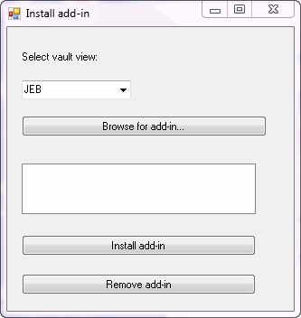

Install Add-in Example (C#)
This example shows how to install an add-in, obtain information about it, and uninstall it.
NOTE: If using the primary interop assembly provided with SOLIDWORKS PDM Professional, see Using .NET Framework 4.0 in Stand-alone Applications.
// Preconditions:
//  1. Start Microsoft Visual Studio.
//     a. Click File > New > Project > Visual C# > Windows Forms Application.
//     b. Type AddinMgr_CSharp in Name.
//     c. Click Browse and navigate to the folder where to create the project.
//     d. Click OK
//     e. Click Show All Files in the Solution Explorer toolbar and expand
//        Form1.cs in the Solution Explorer.
//     f. Create a form similar to the form shown above and change:
//        1. Top label to VaultsLabel.
//        2. Combo box to VaultsComboBox.
//        3. Browse for add-in button to BrowseButton.
//        4. List box to AddinListBox.
//        5. Install add-in button to LoadAddin.
//     g. Replace the code in Form1.cs with this code.
//     h. Replace the code in Form1.Designer.cs with this code.

//  1. The Install add-in dialog box displays.
//     a. Select a vault view.
//     b. Click Browse for add-in.
//     c. In the Browse for add-ins dialog:
//        1. Navigate to your add-in directory and click addin_name.dll
//           and EPDM.Interop.epdm.dll.
//        2. Click Open.
//     d. Click Install add-in.
//        A message box containing information about each add-in installed in
//        the selected vault displays.
//     e. Click OK to close each message box.
//     f. Click Remove add-in.
//  2. Close the Install add-in dialog box.

            /// </summary>
    private void InitializeComponent()
            this.VaultsLabel = new System.Windows.Forms.Label();
            this.VaultsComboBox = new System.Windows.Forms.ComboBox();
            this.BrowseButton = new System.Windows.Forms.Button();
            this.AddinListBox = new System.Windows.Forms.ListBox();
            this.LoadAddin = new System.Windows.Forms.Button();
            this.AddinOpenFileDialog = new System.Windows.Forms.OpenFileDialog();
            this.button1 = new System.Windows.Forms.Button();
            this.SuspendLayout();
            // VaultsLabel
            this.VaultsLabel.AutoSize = true;
            this.VaultsLabel.Location = new System.Drawing.Point(13, 26);
            this.VaultsLabel.Name = "VaultsLabel";
            this.VaultsLabel.Size = new System.Drawing.Size(91, 13);
            this.VaultsLabel.TabIndex = 0;
            this.VaultsLabel.Text = "Select vault view:";
            // VaultsComboBox
            this.VaultsComboBox.FormattingEnabled = true;
            this.VaultsComboBox.Location = new System.Drawing.Point(16, 59);
            this.VaultsComboBox.Name = "VaultsComboBox";
            this.VaultsComboBox.Size = new System.Drawing.Size(121, 21);
            this.VaultsComboBox.TabIndex = 1;
            // BrowseButton
            this.BrowseButton.Location = new System.Drawing.Point(16, 98);
            this.BrowseButton.Name = "BrowseButton";
            this.BrowseButton.Size = new System.Drawing.Size(271, 23);
            this.BrowseButton.TabIndex = 3;
            this.BrowseButton.Text = "Browse for add-in...";
            this.BrowseButton.UseVisualStyleBackColor = true;
            this.BrowseButton.Click += new System.EventHandler(this.BrowseButton_Click);
            // AddinListBox
            this.AddinListBox.FormattingEnabled = true;
            this.AddinListBox.HorizontalScrollbar = true;
            this.AddinListBox.Location = new System.Drawing.Point(16, 151);
            this.AddinListBox.Name = "AddinListBox";
            this.AddinListBox.SelectionMode = System.Windows.Forms.SelectionMode.MultiSimple;
            this.AddinListBox.Size = new System.Drawing.Size(259, 56);
            this.AddinListBox.TabIndex = 4;
            // LoadAddin
            this.LoadAddin.Location = new System.Drawing.Point(16, 230);
            this.LoadAddin.Name = "LoadAddin";
            this.LoadAddin.Size = new System.Drawing.Size(259, 23);
            this.LoadAddin.TabIndex = 5;
            this.LoadAddin.Text = "Install add-in";
            this.LoadAddin.UseVisualStyleBackColor = true;
            this.LoadAddin.Click += new System.EventHandler(this.LoadAddin_Click);
            // AddinOpenFileDialog
            this.AddinOpenFileDialog.Multiselect = true;
            this.AddinOpenFileDialog.Title = "Browse for add-ins";
            // button1
            this.button1.Location = new System.Drawing.Point(16, 260);
            this.button1.Name = "button1";
            this.button1.Size = new System.Drawing.Size(259, 23);
            this.button1.TabIndex = 6;
            this.button1.Text = "Remove add-in";
            this.button1.UseVisualStyleBackColor = true;
            this.button1.Enabled = false;
            this.button1.Click += new System.EventHandler(this.button1_Click);
            // Form1
            this.AutoScaleDimensions = new System.Drawing.SizeF(6F, 13F);
            this.AutoScaleMode = System.Windows.Forms.AutoScaleMode.Font;
            this.ClientSize = new System.Drawing.Size(317, 308);
            this.Controls.Add(this.button1);
            this.Controls.Add(this.LoadAddin);
            this.Controls.Add(this.AddinListBox);
            this.Controls.Add(this.BrowseButton);
            this.Controls.Add(this.VaultsComboBox);
            this.Controls.Add(this.VaultsLabel);
            this.Name = "Form1";
            this.Text = "Install add-in";
            this.Load += new System.EventHandler(this.Form1_Load);
            this.ResumeLayout(false);
            this.PerformLayout();
    #endregion
    private System.Windows.Forms.OpenFileDialog AddinOpenFileDialog;
    private System.Windows.Forms.Label VaultsLabel;
    private System.Windows.Forms.ComboBox VaultsComboBox;
    private System.Windows.Forms.Button BrowseButton;
    private System.Windows.Forms.ListBox AddinListBox;
    private System.Windows.Forms.Button LoadAddin;
    private System.Windows.Forms.Button button1;
