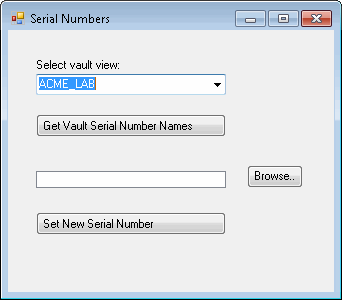

' Postconditions:
'  1. Displays the Serial Numbers dialog box.
'  2. Select a vault view.
'  3. Click Get Vault Serial Number Names.
'  4. Displays a message box containing the names of the serial number
'     generators for the selected vault.
'  5. Click OK to close the message box.
'  6. Click Browse.
'     a. Click a checked-out file in the selected vault whose
'        data card has a Part Number variable.
'     b. Click Open.
'     The selected file's path and file name appear in the Serial
'     Numbers dialog box.
'  7. Click Set New Serial Number
'  8. Displays a message box verifying that the Part Number was
'     set and shows the value of that Part Number.
'     NOTES:
'     * The value set for the Part Number is the next number in the first
'       serial number generator shown in the message box displayed in
'       step 3.
'     * Make note of the Part Number.
'  9. Click OK to close the message box.
' 10. Check in the file whose Part Number was set in step 7, then check out
'     file.
' 11. Examine the Part Number on the data card of the checked-out file.
' 12. Close the Serial Numbers dialog box.
