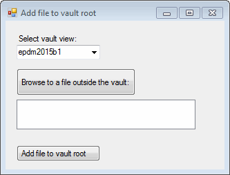

' Postconditions:
' 1. Displays the Add file to vault root dialog box.
'    a. Select a vault view.
'    b. Click Browse to a file outside the vault
'       1. Locate a file outside the vault that exists in
'          a subfolder in the vault.
'       2. Click Open.
'    c. Click Add file to vault root to add the selected file to the
'       root folder of the vault.
'    d. Displays a message box warning you that the selected file is not
'       unique in the vault, but that the file will be added to the vault root.
'    e. Click OK.
' 2. Close the Add file to vault root dialog box.
' 3. Examine the vault root.

        Me.Name = "Form1"
        Me.Text = "Add file to vault root"
        Me.ResumeLayout(False)
        Me.PerformLayout()
    End Sub
#End Region
    Friend WithEvents VaultsLabel As System.Windows.Forms.Label
    Friend WithEvents VaultsComboBox As System.Windows.Forms.ComboBox
    Friend WithEvents BrowseButton As System.Windows.Forms.Button
    Friend WithEvents ListBox As System.Windows.Forms.ListBox
    Friend WithEvents AddFiles As System.Windows.Forms.Button
    Friend WithEvents OpenFileDialog As System.Windows.Forms.OpenFileDialog
End Class
