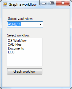

' Preconditions:
' 1. Start Microsoft Visual Studio.
'    a. Click File > New > Project > Visual Basic > Windows Forms Application.
'    b. Type PaintWorkflowGraph in Name.
'    c. Click Browse and navigate to the folder where to create
'       the project.
'    d. Click OK
'    e. Click Show All Files in the Solution Explorer toolbar and expand
'       Form1.vb in the Solution Explorer.
'    f. Replace the code in Form1.vb with this code.
'    g. To create the form, replace the code in Form1.Designer.vb with this code.
' 2. Add EPDM.Interop.epdm.dll as a reference (right-click the project
'    name in the Solution Explorer, click Add Reference, click
'    Assemblies > Framework in the left-side panel, browse to the top folder of
'    your SOLIDWORKS PDM Professional installation, locate and click
'    EPDM.Interop.epdm.dll, click Open, click Add, and click Close).
' 3. Right-click EPDM.Interop.epdm in References, click Properties, and set
'    Embed Interop Types to False to handle methods that pass arrays of
'    structures.
' 4. Click Debug > Start Debugging or press F5.
' Postconditions:
' 1. Displays the Graph a workflow dialog box.
' 2. Maximize the dialog box for the workflow graph.
' 3. Select a vault view.
' 4. Click a workflow.
' 5. Click Graph workflow
' 6. Graphs the selected workflow in the dialog box.
' 7. Close the Graph a workflow dialog box.

End Class

'Form1.Designer.vb

        'Form1
        Me.AutoScaleDimensions = New System.Drawing.SizeF(6.0!, 13.0!)
        Me.AutoScaleMode = System.Windows.Forms.AutoScaleMode.Font
        Me.ClientSize = New System.Drawing.Size(227, 262)
        Me.Controls.Add(Me.Label1)
        Me.Controls.Add(Me.ListBox1)
        Me.Controls.Add(Me.GraphWorkflow)
        Me.Controls.Add(Me.VaultsComboBox)
        Me.Controls.Add(Me.VaultsLabel)
        Me.Name = "Form1"
        Me.Text = "Graph a workflow"
        Me.ResumeLayout(False)
        Me.PerformLayout()
