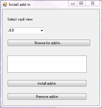

Install Add-in Example (VB.NET)
This example shows how to install an add-in, obtain information about it, and uninstall it.
NOTE: If using the primary interop assembly provided with SOLIDWORKS PDM Professional, see Using .NET Framework 4.0 in Stand-alone Applications.
' Preconditions:
'  1. Start Microsoft Visual Studio.
'     a. Click File > New > Project > Visual Basic > Windows Forms Application.
'     b. Type AddinMgr in Name.
'     c. Click Browse and navigate to the folder where to create the project.
'     d. Click OK
'     e. Click Show All Files in the Solution Explorer toolbar and expand
'        Form1.vb in the Solution Explorer.
'     f. Create a form similar to the form shown above and change:
'        1. Top label to VaultsLabel.
'        2. Combo box to VaultsComboBox.
'        3. Browse for add-in button to BrowseButton.
'        4. List box to AddinListBox.
'        5. Install add-in button to LoadAddin.
'     g. Replace the code in Form1.vb with this code.
'     h. Replace the code in Form1.Designer.vb with this code.
'  2. Add EPDM.Interop.epdm.dll as a reference (right-click the project
'     name in the Solution Explorer, click Add Reference, click
'     Assemblies > Framework in the left-side panel, browse to the top folder of
'     your SOLIDWORKS PDM Professional installation, locate and click
'     EPDM.Interop.epdm.dll, click Open, click Add, and click Close).
'  3. Right-click EPDM.Interop.epdm in References, click Properties, and set
'     Embed Interop Types to False to handle methods that pass arrays of
'     structures.
'  4. Click Debug > Start Debugging or press F5.
' Postconditions:
'  1. The Install add-in dialog box displays.
'     a. Select a vault view.
'     b. Click Browse for add-in.
'     c. In the Browse for add-ins dialog:
'        1. Navigate to your add-in directory and click addin_name.dll
'           and EPDM.Interop.epdm.dll.
'        2. Click Open.
'     d. Click Install add-in.
'        A message box containing information about each add-in installed in
'        the selected vault displays.
'     e. Click OK to close each message box.
'     f. Click Remove add-in.
'  2. Close the Install add-in dialog box.

#Region "Windows Form Designer generated code"
    ''' <summary>
        ''' Required method for Designer support - do not modify
        ''' the contents of this method with the code editor.
        ''' </summary>
    Private Sub InitializeComponent()
        Me.VaultsLabel = New System.Windows.Forms.Label()
        Me.VaultsComboBox = New System.Windows.Forms.ComboBox()
        Me.BrowseButton = New System.Windows.Forms.Button()
        Me.AddinListBox = New System.Windows.Forms.ListBox()
        Me.LoadAddin = New System.Windows.Forms.Button()
        Me.AddinOpenFileDialog = New System.Windows.Forms.OpenFileDialog()
        Me.Button1 = New System.Windows.Forms.Button()
        Me.SuspendLayout()
        'VaultsLabel
        Me.VaultsLabel.AutoSize = True
        Me.VaultsLabel.Location = New System.Drawing.Point(13, 26)
        Me.VaultsLabel.Name = "VaultsLabel"
        Me.VaultsLabel.Size = New System.Drawing.Size(91, 13)
        Me.VaultsLabel.TabIndex = 0
        Me.VaultsLabel.Text = "Select vault view:"
        'VaultsComboBox
        Me.VaultsComboBox.FormattingEnabled = True
        Me.VaultsComboBox.Location = New System.Drawing.Point(16, 59)
        Me.VaultsComboBox.Name = "VaultsComboBox"
        Me.VaultsComboBox.Size = New System.Drawing.Size(121, 21)
        Me.VaultsComboBox.TabIndex = 1
        'BrowseButton
        Me.BrowseButton.Location = New System.Drawing.Point(16, 98)
        Me.BrowseButton.Name = "BrowseButton"
        Me.BrowseButton.Size = New System.Drawing.Size(271, 23)
        Me.BrowseButton.TabIndex = 3
        Me.BrowseButton.Text = "Browse for add-in..."
        Me.BrowseButton.UseVisualStyleBackColor = True
        'AddinListBox
        Me.AddinListBox.FormattingEnabled = True
        Me.AddinListBox.HorizontalScrollbar = True
        Me.AddinListBox.Location = New System.Drawing.Point(16, 151)
        Me.AddinListBox.Name = "AddinListBox"
        Me.AddinListBox.SelectionMode = System.Windows.Forms.SelectionMode.MultiSimple
        Me.AddinListBox.Size = New System.Drawing.Size(259, 56)
        Me.AddinListBox.TabIndex = 4
        'Load add-in
        Me.LoadAddin.Location = New System.Drawing.Point(16, 230)
        Me.LoadAddin.Name = "LoadAddin"
        Me.LoadAddin.Size = New System.Drawing.Size(259, 23)
        Me.LoadAddin.TabIndex = 5
        Me.LoadAddin.Text = "Install add-in"
        Me.LoadAddin.UseVisualStyleBackColor = True
        'AddinOpenFileDialog
        Me.AddinOpenFileDialog.Multiselect = True
        Me.AddinOpenFileDialog.Title = "Browse for add-ins"
        'Remove add-in
        Me.Button1.Location = New System.Drawing.Point(16, 273)
        Me.Button1.Name = "Button1"
        Me.Button1.Size = New System.Drawing.Size(259, 23)
        Me.Button1.TabIndex = 6
        Me.Button1.Text = "Remove add-in"
        Me.Button1.UseVisualStyleBackColor = True
        Me.Button1.Enabled = False
        'Form1
        Me.AutoScaleDimensions = New System.Drawing.SizeF(6.0!, 13.0!)
        Me.AutoScaleMode = System.Windows.Forms.AutoScaleMode.Font
        Me.ClientSize = New System.Drawing.Size(317, 314)
        Me.Controls.Add(Me.Button1)
        Me.Controls.Add(Me.LoadAddin)
        Me.Controls.Add(Me.AddinListBox)
        Me.Controls.Add(Me.BrowseButton)
        Me.Controls.Add(Me.VaultsComboBox)
        Me.Controls.Add(Me.VaultsLabel)
        Me.Name = "Form1"
        Me.Text = "Install add-in"
        Me.ResumeLayout(False)
        Me.PerformLayout()
    End Sub
#End Region
