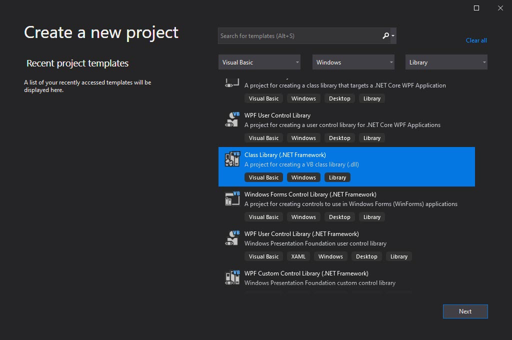

  • Open Visual Studio
  • File -> New -> Project
  • Select Visual CBasic -> Class Library
Click OK.

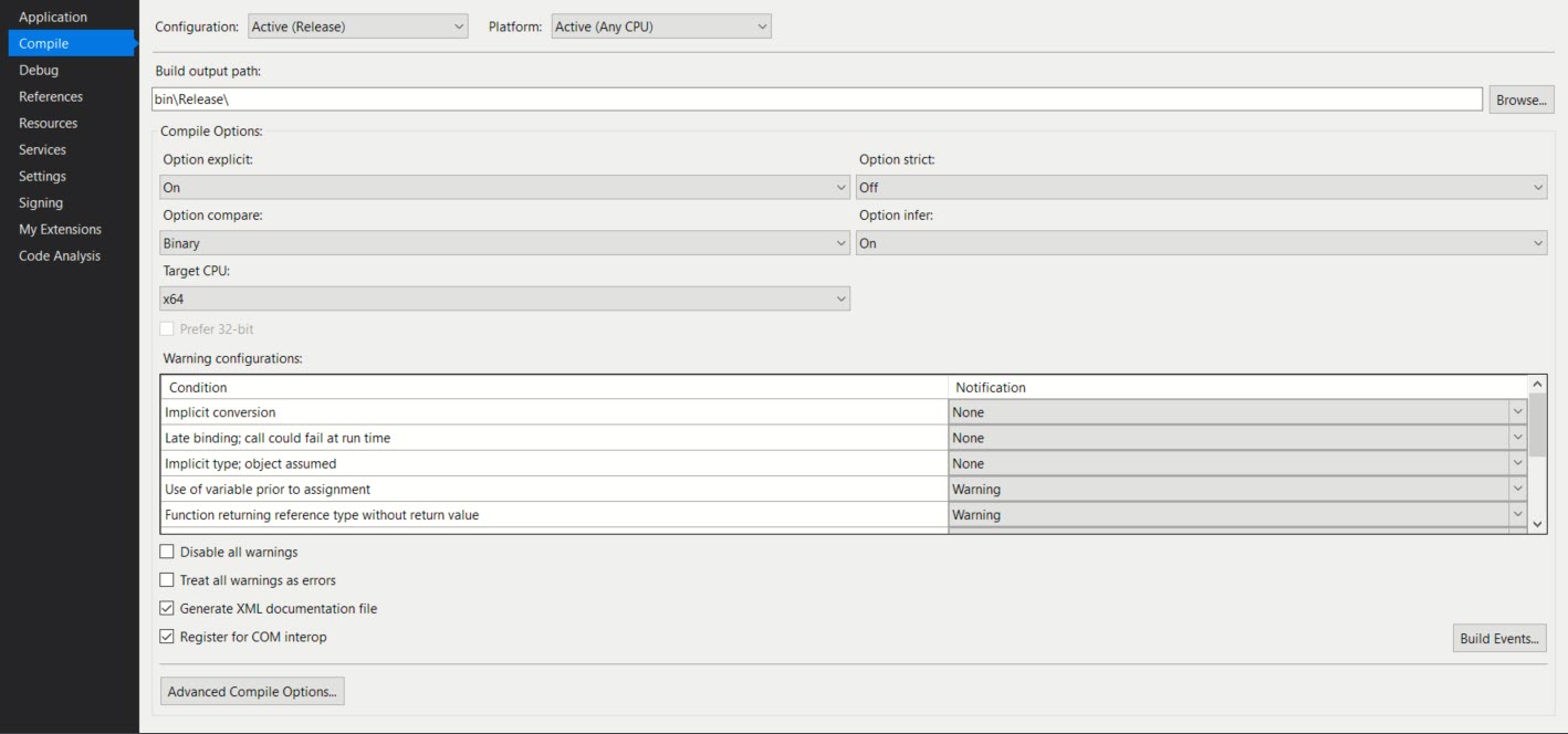

In the solution tree -> Go to project properties.
Verify that solution platform is x64
Otherwise create it.
In Build tab, select platform x64 and check "Register for COM interop"

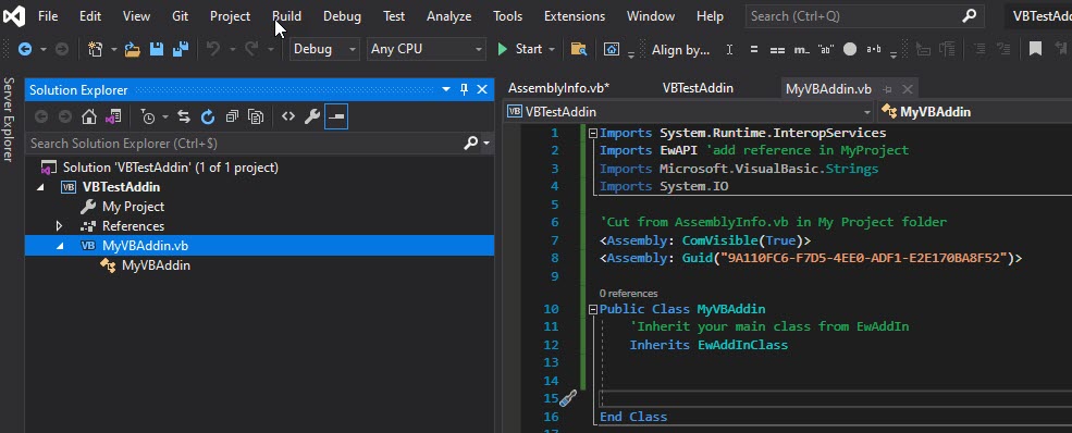

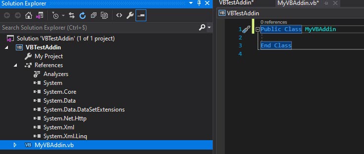

Rename Class1.vb file with an appropriate name for the add-in.
Modify code to make the Add-in

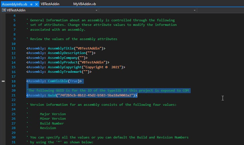

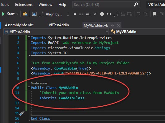

Open AssemblyInfo.vb in My Project folder, cut selected lines below:
  • Paste it in the MyVBAddin.vb
  • Verify that you have ComVisible(true) and not ComVisible(false).
  • Add: Imports System.Runtime.InteropServices;
Like in screen shot below:

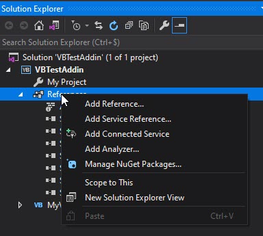

Include reference to EwAPIX.dll
Right click on Reference and select Add reference...
Browse to the location of EwAPIX.dll
Add: Imports EwAPI;

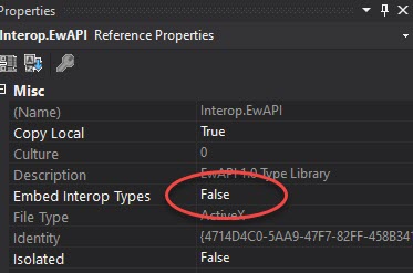

if Erreur BC31541 Change EwAPI (in references on the right) to incorporate... to false
