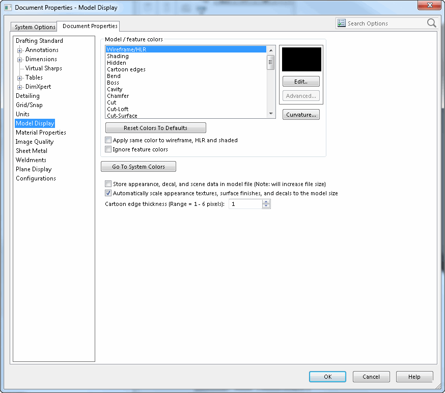

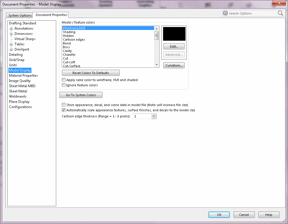

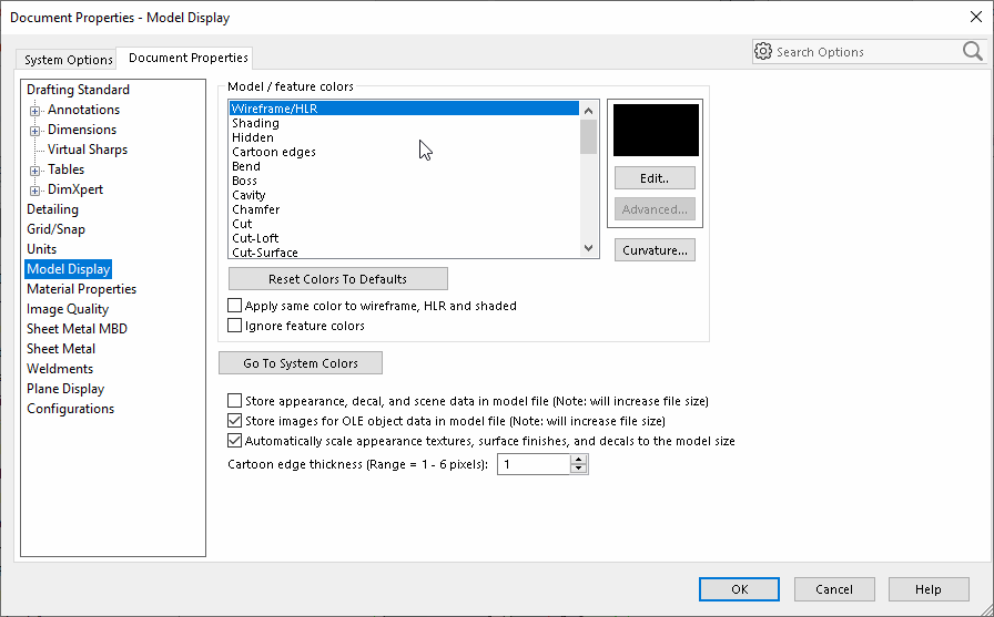

Document Properties > Model Display
Setting
Get/Set Methods
Return Value or <Value>
Comments
Model/Feature colors - Wireframe/HLR
IModelDocExtension::GetUserPreferenceInteger(swUserPreferenceIntegerValue_e.swDocumentColorWireFrame, swUserPreferenceOption_e.swDetailingNoOptionSpecified)
IModelDocExtension::SetUserPreferenceInteger(swUserPreferenceIntegerValue_e.swDocumentColorWireFrame, swUserPreferenceOption_e.swDetailingNoOptionSpecified, <Value>)
See IColorTable for valid options
Model/Feature colors - Shading
IModelDocExtension::GetUserPreferenceInteger(swUserPreferenceIntegerValue_e.swDocumentColorShading, swUserPreferenceOption_e.swDetailingNoOptionSpecified)
IModelDocExtension::SetUserPreferenceInteger(swUserPreferenceIntegerValue_e.swDocumentColorShading, swUserPreferenceOption_e.swDetailingNoOptionSpecified, <Value>)
Model/Feature colors - Hidden
IModelDocExtension::GetUserPreferenceInteger(swUserPreferenceIntegerValue_e.swDocumentColorHidden, swUserPreferenceOption_e.swDetailingNoOptionSpecified)
IModelDocExtension::SetUserPreferenceInteger(swUserPreferenceIntegerValue_e.swDocumentColorHidden, swUserPreferenceOption_e.swDetailingNoOptionSpecified, <Value>)
Model/Feature colors - Bend
IModelDocExtension::GetUserPreferenceInteger(swUserPreferenceIntegerValue_e.swDocumentColorFeatBend, swUserPreferenceOption_e.swDetailingNoOptionSpecified)
IModelDocExtension::SetUserPreferenceInteger(swUserPreferenceIntegerValue_e.swDocumentColorFeatBend, swUserPreferenceOption_e.swDetailingNoOptionSpecified, <Value>)
Model/Feature colors - Boss
IModelDocExtension::GetUserPreferenceInteger(swUserPreferenceIntegerValue_e.swDocumentColorFeatBoss, swUserPreferenceOption_e.swDetailingNoOptionSpecified)
IModelDocExtension::SetUserPreferenceInteger(swUserPreferenceIntegerValue_e.swDocumentColorFeatBoss, swUserPreferenceOption_e.swDetailingNoOptionSpecified, <Value>)
Model/Feature colors - Cavity
IModelDocExtension::GetUserPreferenceInteger(swUserPreferenceIntegerValue_e.swDocumentColorFeatCavity, swUserPreferenceOption_e.swDetailingNoOptionSpecified)
IModelDocExtension::SetUserPreferenceInteger(swUserPreferenceIntegerValue_e.swDocumentColorFeatCavity, swUserPreferenceOption_e.swDetailingNoOptionSpecified, <Value>)
Model/Feature colors - Chamfer
IModelDocExtension::GetUserPreferenceInteger(swUserPreferenceIntegerValue_e.swDocumentColorFeatChamfer, swUserPreferenceOption_e.swDetailingNoOptionSpecified)
IModelDocExtension::SetUserPreferenceInteger(swUserPreferenceIntegerValue_e.swDocumentColorFeatChamfer, swUserPreferenceOption_e.swDetailingNoOptionSpecified, <Value>)
Model/Feature colors - Cut
IModelDocExtension::GetUserPreferenceInteger(swUserPreferenceIntegerValue_e.swDocumentColorFeatCut, swUserPreferenceOption_e.swDetailingNoOptionSpecified)
IModelDocExtension::SetUserPreferenceInteger(swUserPreferenceIntegerValue_e.swDocumentColorFeatCut, swUserPreferenceOption_e.swDetailingNoOptionSpecified, <Value>)
Model/Feature colors - Cut-Loft
IModelDocExtension::GetUserPreferenceInteger(swUserPreferenceIntegerValue_e.swDocumentColorFeatLoftCut, swUserPreferenceOption_e.swDetailingNoOptionSpecified)
IModelDocExtension::SetUserPreferenceInteger(swUserPreferenceIntegerValue_e.swDocumentColorFeatLoftCut, swUserPreferenceOption_e.swDetailingNoOptionSpecified, <Value>)
Model/Feature colors - Cut-Surface
IModelDocExtension::GetUserPreferenceInteger(swUserPreferenceIntegerValue_e.swDocumentColorFeatSurfCut, swUserPreferenceOption_e.swDetailingNoOptionSpecified)
IModelDocExtension::SetUserPreferenceInteger(swUserPreferenceIntegerValue_e.swDocumentColorFeatSurfCut, swUserPreferenceOption_e.swDetailingNoOptionSpecified, <Value>)
Model/Feature colors - Cut-Sweep
IModelDocExtension::GetUserPreferenceInteger(swUserPreferenceIntegerValue_e.swDocumentColorFeatSweepCut, swUserPreferenceOption_e.swDetailingNoOptionSpecified)
IModelDocExtension::SetUserPreferenceInteger(swUserPreferenceIntegerValue_e.swDocumentColorFeatSweepCut, swUserPreferenceOption_e.swDetailingNoOptionSpecified, <Value>)
Model/Feature colors - Weld Bead
IModelDocExtension::GetUserPreferenceInteger(swUserPreferenceIntegerValue_e.swDocumentColorFeatWeldBead, swUserPreferenceOption_e.swDetailingNoOptionSpecified)
IModelDocExtension::SetUserPreferenceInteger(swUserPreferenceIntegerValue_e.swDocumentColorFeatWeldBead, swUserPreferenceOption_e.swDetailingNoOptionSpecified, <Value>)
Model/Feature colors - Extrude
IModelDocExtension::GetUserPreferenceInteger(swUserPreferenceIntegerValue_e.swDocumentColorFeatExtrude, swUserPreferenceOption_e.swDetailingNoOptionSpecified)
IModelDocExtension::SetUserPreferenceInteger(swUserPreferenceIntegerValue_e.swDocumentColorFeatExtrude, swUserPreferenceOption_e.swDetailingNoOptionSpecified, <Value>)
Model/Feature colors - Fillet
IModelDocExtension::GetUserPreferenceInteger(swUserPreferenceIntegerValue_e.swDocumentColorFeatFillet, swUserPreferenceOption_e.swDetailingNoOptionSpecified)
IModelDocExtension::SetUserPreferenceInteger(swUserPreferenceIntegerValue_e.swDocumentColorFeatFillet, swUserPreferenceOption_e.swDetailingNoOptionSpecified, <Value>)
Model/Feature colors - Hole
IModelDocExtension::GetUserPreferenceInteger(swUserPreferenceIntegerValue_e.swDocumentColorFeatHole, swUserPreferenceOption_e.swDetailingNoOptionSpecified)
IModelDocExtension::SetUserPreferenceInteger(swUserPreferenceIntegerValue_e.swDocumentColorFeatHole, swUserPreferenceOption_e.swDetailingNoOptionSpecified, <Value>)
Model/Feature colors - Library Feature
IModelDocExtension::GetUserPreferenceInteger(swUserPreferenceIntegerValue_e.swDocumentColorFeatLibrary, swUserPreferenceOption_e.swDetailingNoOptionSpecified)
IModelDocExtension::SetUserPreferenceInteger(swUserPreferenceIntegerValue_e.swDocumentColorFeatLibrary, swUserPreferenceOption_e.swDetailingNoOptionSpecified, <Value>)
Model/Feature colors - Loft
IModelDocExtension::GetUserPreferenceInteger(swUserPreferenceIntegerValue_e.swDocumentColorFeatLoft, swUserPreferenceOption_e.swDetailingNoOptionSpecified)
IModelDocExtension::SetUserPreferenceInteger(swUserPreferenceIntegerValue_e.swDocumentColorFeatLoft, swUserPreferenceOption_e.swDetailingNoOptionSpecified, <Value>)
Model/Feature colors - MidSurface
IModelDocExtension::GetUserPreferenceInteger(swUserPreferenceIntegerValue_e.swDocumentColorFeatMidSurface, swUserPreferenceOption_e.swDetailingNoOptionSpecified)
IModelDocExtension::SetUserPreferenceInteger(swUserPreferenceIntegerValue_e.swDocumentColorFeatMidSurface, swUserPreferenceOption_e.swDetailingNoOptionSpecified, <Value>)
Model/Feature colors - Pattern
IModelDocExtension::GetUserPreferenceInteger(swUserPreferenceIntegerValue_e.swDocumentColorFeatPattern, swUserPreferenceOption_e.swDetailingNoOptionSpecified)
IModelDocExtension::SetUserPreferenceInteger(swUserPreferenceIntegerValue_e.swDocumentColorFeatPattern, swUserPreferenceOption_e.swDetailingNoOptionSpecified, <Value>)
Model/Feature colors - Surface
IModelDocExtension::GetUserPreferenceInteger(swUserPreferenceIntegerValue_e.swDocumentColorFeatRefSurface, swUserPreferenceOption_e.swDetailingNoOptionSpecified)
IModelDocExtension::SetUserPreferenceInteger(swUserPreferenceIntegerValue_e.swDocumentColorFeatRefSurface, swUserPreferenceOption_e.swDetailingNoOptionSpecified, <Value>)
Model/Feature colors - Revolution
IModelDocExtension::GetUserPreferenceInteger(swUserPreferenceIntegerValue_e.swDocumentColorFeatRevolution, swUserPreferenceOption_e.swDetailingNoOptionSpecified)
IModelDocExtension::SetUserPreferenceInteger(swUserPreferenceIntegerValue_e.swDocumentColorFeatRevolution, swUserPreferenceOption_e.swDetailingNoOptionSpecified, <Value>)
Model/Feature colors - Shell
IModelDocExtension::GetUserPreferenceInteger(swUserPreferenceIntegerValue_e.swDocumentColorFeatShell, swUserPreferenceOption_e.swDetailingNoOptionSpecified)
IModelDocExtension::SetUserPreferenceInteger(swUserPreferenceIntegerValue_e.swDocumentColorFeatShell, swUserPreferenceOption_e.swDetailingNoOptionSpecified, <Value>)
Model/Feature colors - Derived Part
IModelDocExtension::GetUserPreferenceInteger(swUserPreferenceIntegerValue_e.swDocumentColorFeatDerivedPart, swUserPreferenceOption_e.swDetailingNoOptionSpecified)
IModelDocExtension::SetUserPreferenceInteger(swUserPreferenceIntegerValue_e.swDocumentColorFeatDerivedPart, swUserPreferenceOption_e.swDetailingNoOptionSpecified, <Value>)
Model/Feature colors - Sweep
IModelDocExtension::GetUserPreferenceInteger(swUserPreferenceIntegerValue_e.swDocumentColorFeatSweep, swUserPreferenceOption_e.swDetailingNoOptionSpecified)
IModelDocExtension::SetUserPreferenceInteger(swUserPreferenceIntegerValue_e.swDocumentColorFeatSweep, swUserPreferenceOption_e.swDetailingNoOptionSpecified, <Value>)
Model/Feature colors - Thicken
IModelDocExtension::GetUserPreferenceInteger(swUserPreferenceIntegerValue_e.swDocumentColorFeatThicken, swUserPreferenceOption_e.swDetailingNoOptionSpecified)
IModelDocExtension::SetUserPreferenceInteger(swUserPreferenceIntegerValue_e.swDocumentColorFeatThicken, swUserPreferenceOption_e.swDetailingNoOptionSpecified, <Value>)
Model/Feature colors - Rib
IModelDocExtension::GetUserPreferenceInteger(swUserPreferenceIntegerValue_e.swDocumentColorFeatRib, swUserPreferenceOption_e.swDetailingNoOptionSpecified)
IModelDocExtension::SetUserPreferenceInteger(swUserPreferenceIntegerValue_e.swDocumentColorFeatRib, swUserPreferenceOption_e.swDetailingNoOptionSpecified, <Value>)
Model/Feature colors - Dome
IModelDocExtension::GetUserPreferenceInteger(swUserPreferenceIntegerValue_e.swDocumentColorFeatDome, swUserPreferenceOption_e.swDetailingNoOptionSpecified)
IModelDocExtension::SetUserPreferenceInteger(swUserPreferenceIntegerValue_e.swDocumentColorFeatDome, swUserPreferenceOption_e.swDetailingNoOptionSpecified, <Value>)
Model/Feature colors - Form feature
IModelDocExtension::GetUserPreferenceInteger(swUserPreferenceIntegerValue_e.swDocumentColorFeatForm, swUserPreferenceOption_e.swDetailingNoOptionSpecified)
IModelDocExtension::SetUserPreferenceInteger(swUserPreferenceIntegerValue_e.swDocumentColorFeatForm, swUserPreferenceOption_e.swDetailingNoOptionSpecified, <Value>)
Model/Feature colors - Shape Feature
IModelDocExtension::GetUserPreferenceInteger(swUserPreferenceIntegerValue_e.swDocumentColorFeatShape, swUserPreferenceOption_e.swDetailingNoOptionSpecified)
IModelDocExtension::SetUserPreferenceInteger(swUserPreferenceIntegerValue_e.swDocumentColorFeatShape, swUserPreferenceOption_e.swDetailingNoOptionSpecified, <Value>)
Model/Feature colors - Replace Face
IModelDocExtension::GetUserPreferenceInteger(swUserPreferenceIntegerValue_e.swDocumentColorFeatReplaceFace, swUserPreferenceOption_e.swDetailingNoOptionSpecified)
IModelDocExtension::SetUserPreferenceInteger(swUserPreferenceIntegerValue_e.swDocumentColorFeatReplaceFace, swUserPreferenceOption_e.swDetailingNoOptionSpecified, <Value>)
Model/Feature colors - Structural Member
IModelDocExtension::GetUserPreferenceInteger(swUserPreferenceIntegerValue_e.swDocumentColorFeatStructuralMember, swUserPreferenceOption_e.swDetailingNoOptionSpecified)
IModelDocExtension::SetUserPreferenceInteger(swUserPreferenceIntegerValue_e.swDocumentColorFeatStructuralMember, swUserPreferenceOption_e.swDetailingNoOptionSpecified, <Value>)
Model/Feature colors - Gusset
IModelDocExtension::GetUserPreferenceInteger(swUserPreferenceIntegerValue_e.swDocumentColorFeatGusset, swUserPreferenceOption_e.swDetailingNoOptionSpecified)
IModelDocExtension::SetUserPreferenceInteger(swUserPreferenceIntegerValue_e.swDocumentColorFeatGusset, swUserPreferenceOption_e.swDetailingNoOptionSpecified, <Value>)
Model/Feature colors - End cap
IModelDocExtension::GetUserPreferenceInteger(swUserPreferenceIntegerValue_e.swDocumentColorFeatEndCap, swUserPreferenceOption_e.swDetailingNoOptionSpecified)
IModelDocExtension::SetUserPreferenceInteger(swUserPreferenceIntegerValue_e.swDocumentColorFeatEndCap, swUserPreferenceOption_e.swDetailingNoOptionSpecified, <Value>)
Model/Feature colors - Wrap
IModelDocExtension::GetUserPreferenceInteger(swUserPreferenceIntegerValue_e.swDocumentColorFeatWrap, swUserPreferenceOption_e.swDetailingNoOptionSpecified)
IModelDocExtension::SetUserPreferenceInteger(swUserPreferenceIntegerValue_e.swDocumentColorFeatWrap, swUserPreferenceOption_e.swDetailingNoOptionSpecified, <Value>)
Model/Feature colors - Apply same color to wireframe, HLR, and shaded
IModelDocExtension::GetUserPreferenceToggle(swUserPreferenceToggle_e.swColorsWireframeHLRShadedSame, swUserPreferenceOption_e.swDetailingNoOptionSpecified)
IModelDocExtension::SetUserPreferenceToggle(swUserPreferenceToggle_e.swColorsWireframeHLRShadedSame, swUserPreferenceOption_e.swDetailingNoOptionSpecified, <Value>)
Boolean value
Specifies whether to apply same color to wireframe, HLR, and shaded
Model/Feature colors - Ignore feature colors
IModelDocExtension::GetUserPreferenceToggle(swUserPreferenceToggle_e.swIgnoreFeatureColors, swUserPreferenceOption_e.swDetailingNoOptionSpecified)
IModelDocExtension::SetUserPreferenceToggle(swUserPreferenceToggle_e.swIgnoreFeatureColors, swUserPreferenceOption_e.swDetailingNoOptionSpecified, <Value>)
Boolean value
For parts only; specifies whether to ignore feature colors
Store appearance, decal, and scene data in model file (Note: will increase file size)
IModelDocExtension::GetUserPreferenceToggle(swUserPreferenceToggle_e.swStoreImagesWithModel, swUserPreferenceOption_e.swDetailingNoOptionSpecified)
IModelDocExtension::SetUserPreferenceToggle(swUserPreferenceToggle_e.swStoreImagesWithModel, swUserPreferenceOption_e.swDetailingNoOptionSpecified, <Value>)
Boolean value
Specifies whether to store images with model
Store images for OLE object data in model file (Note: wil increase file size)
IModelDocExtension::GetUserPreferenceToggle(swUserPreferenceToggle_e.swStoreOLEImagesWithModel, swUserPreferenceOption_e.swDetailingNoOptionSpecified)
IModelDocExtension::SetUserPreferenceToggle(swUserPreferenceToggle_e.swStoreOLEImagesWithModel, swUserPreferenceOption_e.swDetailingNoOptionSpecified, <Value>)
Boolean value
For parts and assemblies only; Default value is true
Automatically scale appearance textures, surface finishes, and decals to the model size
IModelDocExtension::GetUserPreferenceToggle(swUserPreferenceToggle_e.swAutoScaleTextureSFDecalsToModelSize, swUserPreferenceOption_e.swDetailingNoOptionSpecified)
IModelDocExtension::SetUserPreferenceToggle(swUserPreferenceToggle_e.swAutoScaleTextureSFDecalsToModelSize, swUserPreferenceOption_e.swDetailingNoOptionSpecified, <Value>)
Boolean value
Cartoon edge thickness (Range = 1 - 6 pixels)
IModelDocExtension::GetUserPreferenceInteger(swUserPreferenceIntegerValue_e.swCartoonEdgeThickness, swUserPreferenceOption_e.swDetailingNoOptionSpecified)
IModelDocExtension::SetUserPreferenceInteger(swUserPreferenceIntegerValue_e.swCartoonEdgeThickness, swUserPreferenceOption_e.swDetailingNoOptionSpecified, <Value>)
1 <= Integral number of pixels <= 6
Page:   Document Properties > Model Display
