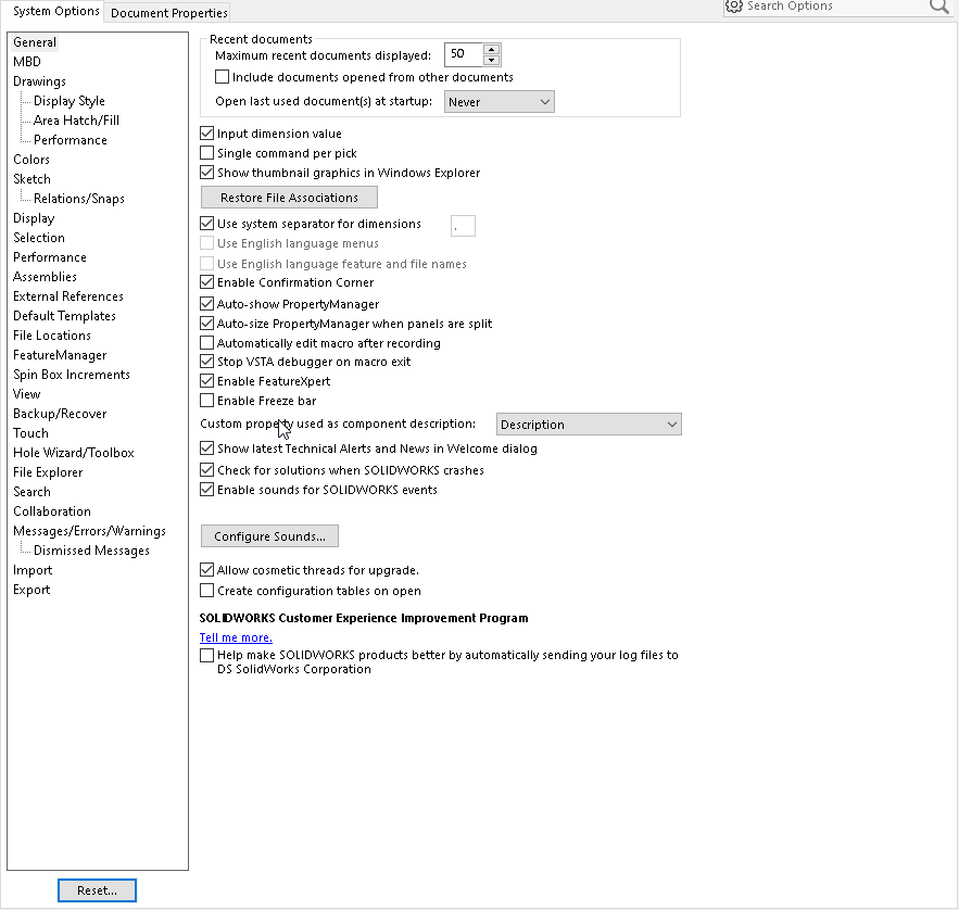

System Options > General
This topic contains two tables. The information in the table:
  • appearing immediately after the screen capture corresponds to the settings on that dialog.
  • titled Obsolete Enumerators contains enumerators that previously appeared on the dialog but are now obsolete.
Setting
Get/Set Methods
Return Value
or
<Value>
or
<OnFlag>
Comment
Recent documents - Maximum recent documents displayed
ISldWorks::GetUserPreferenceIntegerValue(swUserPreferenceIntegerValue_e.swMaximumRecentDocuments)
ISldWorks::SetUserPreferenceIntegerValue(swUserPreferenceIntegerValue_e.swMaximumRecentDocuments, <Value>)
1 <= Integer value <= 100
Specifies how many documents to display in the File > Open Recent list
Recent documents - Include documents opened from other documents
ISldWorks::GetUserPreferenceToggle(swUserPreferenceToggle_e.swIncludeDocumentsOpenedFromOtherDocuments)
ISldWorks::SetUserPreferenceToggle(swUserPreferenceToggle_e.swIncludeDocumentsOpenedFromOtherDocuments, <OnFlag>)
Boolean value
Specifies whether to include the documents opened from other documents in the File > Open Recent list
Recent documents - Open last used document(s) at startup
ISldWorks::GetUserPreferenceToggle(swUserPreferenceToggle_e.swOpenLastUsedDocumentAtStart)
ISldWorks::SetUserPreferenceToggle(swUserPreferenceToggle_e.swOpenLastUsedDocumentAtStart, <OnFlag>)
Boolean value
Specifies whether to open the last-used document when starting up SOLIDWORKS software; true if always, false if never
Input dimension value
ISldWorks::GetUserPreferenceToggle(swUserPreferenceToggle_e.swInputDimValOnCreate)
ISldWorks::SetUserPreferenceToggle(swUserPreferenceToggle_e.swInputDimValOnCreate, <OnFlag>)
Boolean value
Specifies whether to automatically display Modify dialog when dimensioning new entities
Single command per pick
ISldWorks::GetUserPreferenceToggle(swUserPreferenceToggle_e.swSingleCommandPerPick)
ISldWorks::SetUserPreferenceToggle(swUserPreferenceToggle_e.swSingleCommandPerPick, <OnFlag>)
Boolean value
Specifies whether to deselect sketch and dimension tools after each use
Use shaded face highlighting
ISldWorks::GetUserPreferenceToggle(swUserPreferenceToggle_e.swUseShadedFaceHighlight)
ISldWorks::SetUserPreferenceToggle(swUserPreferenceToggle_e.swUseShadedFaceHighlight, <OnFlag>)
Boolean value
Specifies whether selected faces are displayed in a solid color (green by default)
Show thumbnail graphics in File Explorer
ISldWorks::GetUserPreferenceToggle(swUserPreferenceToggle_e.swThumbnailGraphics)
ISldWorks::SetUserPreferenceToggle(swUserPreferenceToggle_e.swThumbnailGraphics, <OnFlag>)
Boolean value
Specifies whether thumbnail graphic instead of an icon in File Explorer is displayed for each SOLIDWORKS part or assembly document
Use system separator for dimensions
ISldWorks::GetUserPreferenceToggle(swUserPreferenceToggle_e.swUseSystemSeparatorForDims)
ISldWorks::SetUserPreferenceToggle(swUserPreferenceToggle_e.swUseSystemSeparatorForDims, <OnFlag>)
Boolean value
Specifies whether default system decimal separator is used when displaying decimal numbers
Use English language menus
ISldWorks::GetUserPreferenceToggle(swUserPreferenceToggle_e.swUseEnglishLanguage)
ISldWorks::SetUserPreferenceToggle(swUserPreferenceToggle_e.swUseEnglishLanguage, <OnFlag>)
Boolean value
Specifies whether to change to English if another language was selected when SOLIDWORKS software was installed;  SOLIDWORKS software must be restarted for this change to take effect
Use English language feature and file names
ISldWorks::GetUserPreferenceToggle(swUserPreferenceToggle_e.swUseEnglishLanguageFeatureNames)
ISldWorks::SetUserPreferenceToggle(swUserPreferenceToggle_e.swUseEnglishLanguageFeatureNames, <OnFlag>)
Boolean value
Specifies whether to use English feature and file names in languages other than English
Enable Confirmation Corner
ISldWorks::GetUserPreferenceToggle(swUserPreferenceToggle_e.swEnableConfirmationCorner)
ISldWorks::SetUserPreferenceToggle(swUserPreferenceToggle_e.swEnableConfirmationCorner, <OnFlag>)
Boolean value
Specifies whether to display Confirmation Corner in the upper-right corner of the graphics area
Auto-show PropertyManager
ISldWorks::GetUserPreferenceToggle(swUserPreferenceToggle_e.swAutoShowPropertyManager)
ISldWorks::SetUserPreferenceToggle(swUserPreferenceToggle_e.swAutoShowPropertyManager, <OnFlag>)
Boolean value
Specifies whether to automatically display PropertyManager when editing an entity
Auto-size PropertyManager when panels are split
ISldWorks::GetUserPreferenceToggle(swUserPreferenceToggle_e.swAutoSizePropertyManager)
ISldWorks::SetUserPreferenceToggle(swUserPreferenceToggle_e.swAutoSizePropertyManager, <OnFlag>)
Boolean value
Specifies whether to autosize PropertyManager pages when panels are split
Automatically edit macro after recording
ISldWorks::GetUserPreferenceToggle(swUserPreferenceToggle_e.swEditMacroAfterRecord)
ISldWorks::SetUserPreferenceToggle(swUserPreferenceToggle_e.swEditMacroAfterRecord, <OnFlag>)
Boolean value
Specifies whether to automatically edit a macro after recording it
NOTE: If after recording a macro you select to save the macro as all macro types (.swp, .csproj, and .vbproj), then this option has no effect.
Stop VSTA debugger on macro exit
ISldWorks::GetUserPreferenceToggle(swUserPreferenceToggle_e.swStopDebuggingVstaOnExit)
ISldWorks::SetUserPreferenceToggle(swUserPreferenceToggle_e.swStopDebuggingVstaOnExit, <OnFlag>)
Boolean value
Specifies whether to stop the debugger when the macro exits main()
IMPORTANT: When debugging VSTA macros with user-interface components such as PropertyManager pages, manipulators, or other objects that use events or handler objects, it is necessary to keep the debugger running after the main() method of the VSTA macro exits.
Enable FeatureXpert
ISldWorks::GetUserPreferenceToggle(swUserPreferenceToggle_e.swUserEnableAutoFix)
ISldWorks::SetUserPreferenceToggle(swUserPreferenceToggle_e.swUserEnableAutoFix, <OnFlag>)
Boolean value
Specifies whether to enable FeatureXpert
Enable Freeze bar
ISldWorks::GetUserPreferenceToggle(swUserPreferenceToggle_e.swUserEnableFreezeBar)
ISldWorks::SetUserPreferenceToggle(swUserPreferenceToggle_e.swUserEnableFreezeBar, <OnFlag>)
Boolean value
Specifies whether to enable or disable the freeze bar
When rebuild error occurs
ISldWorks::GetUserPreferenceIntegerValue(swUserPreferenceIntegerValue_e.swRebuildErrorAction)
ISldWorks::SetUserPreferenceIntegerValue(swUserPreferenceIntegerValue_e.swRebuildErrorAction, swStopContinuePrompt_e.<Value>)
See swStopContinuePrompt_e for valid options
Custom property used as component description
ISldWorks::GetUserPreferenceStringValue(swUserPreferenceStringValue_e.swCustomPropertyUsedAsComponentDescription)
ISldWorks::SetUserPreferenceStringValue(swUserPreferenceStringValue_e.swCustomPropertyUsedAsComponentDescription, <Value>)
String value
Show latest Technical Alerts and News in Welcome dialog
(Not supported in SOLIDWORKS Connected)
ISldWorks::GetUserPreferenceToggle(swUserPreferenceToggle_e.swShowNewsFeedsInTaskPane)
ISldWorks::SetUserPreferenceToggle(swUserPreferenceToggle_e.swShowNewsFeedsInTaskPane, <OnFlag>)
Boolean value
Specifies whether to show the latest Technical Alerts and News in the Welcome dialog
Check for solutions when SOLIDWORKS crashes
ISldWorks::GetUserPreferenceToggle(swUserPreferenceToggle_e.swCheckCrashSolutions)
ISldWorks::SetUserPreferenceToggle(swUserPreferenceToggle_e.swCheckCrashSolutions, <OnFlag>)
Boolean value
Enable sounds for SOLIDWORKS events
ISldWorks::GetUserPreferenceToggle(swUserPreferenceToggle_e.swEnableSoundsForSOLIDWORKSEvents)
ISldWorks::SetUserPreferenceToggle(swUserPreferenceToggle_e.swEnableSoundsForSOLIDWORKSEvents, <OnFlag>)
Boolean value
Allow cosmetic threads for upgrade
ISldWorks::GetUserPreferenceToggle(swUserPreferenceToggle_e.swEnableAllowCosmeticThreadsUpgrade)
ISldWorks::SetUserPreferenceToggle(swUserPreferenceToggle_e.swEnableAllowCosmeticThreadsUpgrade, <OnFlag>)
Boolean value
Specifies whether to upgrade cosmetic threads to the latest design
Create configuration tables on open
ISldWorks::GetUserPreferenceToggle(swUserPreferenceToggle_e.swCreateConfigurationTableOnOpen)
ISldWorks::SetUserPreferenceToggle(swUserPreferenceToggle_e.swCreateConfigurationTableOnOpen, <OnFlag>)
Boolean value
SOLIDWORKS Customer Experience Improvement Program - Help make SOLIDWORKS products better by automatically sending your log files to DS SOLIDWORKS Corporation
ISldWorks::GetUserPreferenceIntegerValue(swUserPreferenceIntegerValue_e.swPerformanceFeedback)
ISldWorks::SetUserPreferenceIntegerValue(swUserPreferenceIntegerValue_e.swPerformanceFeedback, swPerformanceFeedback_e.<Value>)
See swPerformanceFeedback_e for valid options
Specifies whether to enable or disable performance feedback or when to remind the user to enable it

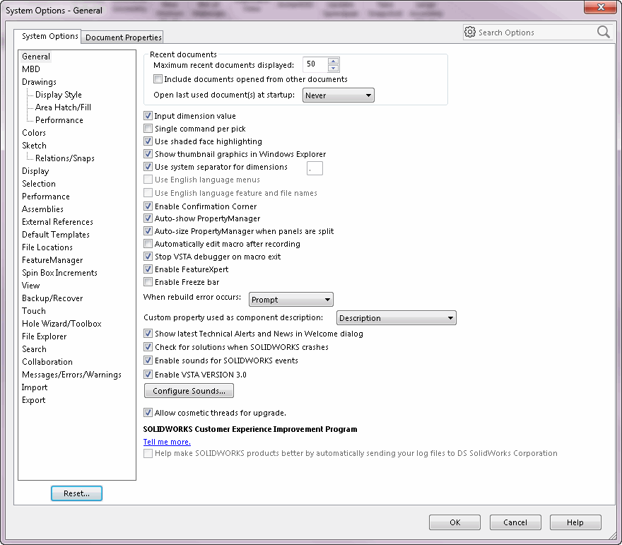

Enumerator
Comment
swEnablePerformanceEmail
Obsolete
swEnablePerformanceFeedback
Obsolete; use swUserPreferenceIntegerValue_e.swPerformanceFeedback (shown in previous table)
swEnablePropertyManager
Obsolete; always enabled
swMaximizeDocumentOnOpen
Obsolete
swSaveEModelData
Obsolete
swShowDimensionNames
Obsolete
swEnableVSTAVersion3
Obsolete
